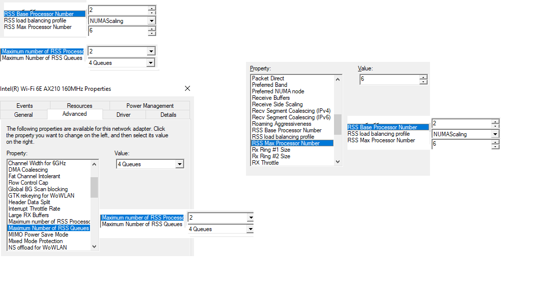

Hello can you please tell me what is the application that u used in the image number 5 ?MeveSPB wrote: ↑09 Feb 2024, 13:41I don't quite understand what you're talking about (sorry English is not my native language). I am not messed with core affinities
(everything is as it is, default).
Interrupt moderation is disabled. Usually, I set up functions according to the following type.
I would also like to add i225 and i226, you can't turn off msi mode (Windows breaks)
10.02.2024
PSI made your recommendations on the RTL8111F-CG chip (D-Link DGE-560T/D2A).kyube wrote: ↑30 Aug 2023, 09:37
Download this driver (for 8125B)
...... (in particular, the Win10 Auto Installation Program (NDIS)
In windows, it's shown as
Driver Date: 11/21/2023
Driver Version: 10.69.1121.2023
- Change limit from MSIUtil from 1 to 4
- Gointerruptpolicy - set "Realtek PCIe GbE Family Controller" from "IrqAllCloseProcessor" to "IrqPolicySpreadMessagesAcrossAllprocessors" or "irqPolicySpecifiedProcessors"
- RSS on, which you do by going in Control Panel\Network and Internet\Network Connections\ and right-clicking the adapter, pressing Properties => Configure => Advanced and turning on "Receive Side Scaling"
- Queues to 2
- RSSBaseProcessor on 2 in registry
What has been done:
1.The driver remains the same (no changes).
2.I looked at the values of "limit" and "max limit" in msi- (1....4) - I had it like that.
3. In GoInterruptPolicy - changed the value to "IrqPolicySpreadMessagesAcrossAllprocessors"
4. Added a new parameter to the registry.
5. - Queues to 2
- RSSBaseProcessor on 2 in registry ...
It worked, I'm thrilled:D![]()
!!! The game has stopped freezing, the mouse has come to life! And it's on a $10 fee!!!!!! I'll test it again, I wonder if I'll get the same feeling on intel (225,226).
And now what should I do with the ASUS XG-C100C (ALQ1070) board?![]()

This is not an application. This is "configuring adapter settings", the "network and Internet" section in WINDOWS 10 settingslookingforanswer wrote: ↑29 Jul 2024, 08:38Hello can you please tell me what is the application that u used in the image number 5 ?
lookingforanswer
- Posts: 2
- Joined: 29 Jul 2024, 08:32
Re: [Ethernet Onboard-vs-USB-vs-PCIe] I finally found the reason behind my input lag after 6 years
Hello bro, thank you for responding back, do you have any recommendations for these settings please ?MeveSPB wrote: ↑30 Jul 2024, 05:26This is not an application. This is "configuring adapter settings", the "network and Internet" section in WINDOWS 10 settingslookingforanswer wrote: ↑29 Jul 2024, 08:38Hello can you please tell me what is the application that u used in the image number 5 ?
