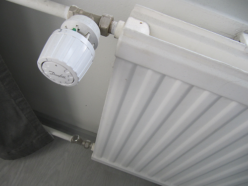

Sorry, I misunderstood you. I thought the radiator was outside of your apartment.
As I now understand you meant basic water heater radiator, as we know those do not have any wires.
And now I might better know what is causing this...
Someone or more than one (in your apartment complex) has used water heater radiator as a ground. This is illegal and very dangerous.
https://diy.stackexchange.com/questions ... e-radiator
Now you have electrical interference flowing through all those apartment complex pipes.
It might a waste to call the electrician as this cannot be fixed. You don't know who has done it.

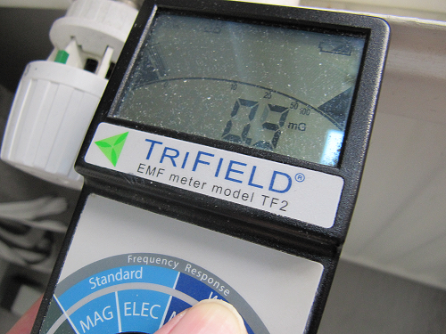

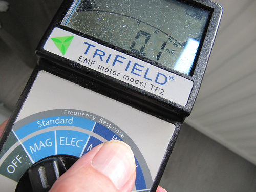

Here's a quick recording I did on my phone using an app called EMF Detector, and while I think it's not showing the actual interference levels, I think it shows how magnetic the radiator is and how that can radiate interference.. or something. The red spike is when I placed my phone right in the spot where the adjustable temperature knob is and where the wall pipe enters into the radiator.

Yeah, it does give some indication that there is something. But I don't think it is very accurate. The numbers should not change.
I have very accurate measurement device, which is quite expensive. Magnetic field does not change, when I move it to close to the water heater radiator. The slight deviation is from my shaking hands. This is as it should be.
Also one cheap way is to use AM radio. The noise should not change.
If you decide to call the electrician you can ask him to use earth leakage current clamp meter on those water pipes (in bathroom also). I just repeat here as a precaution, do not touch bare metal parts on those pipes.

- Near the radiator
- Near.png (407.05 KiB) Viewed 7226 times
- Away
- Away.png (421.48 KiB) Viewed 7226 times
- My water heater radiator
- Waterheater.png (352.07 KiB) Viewed 7226 times
