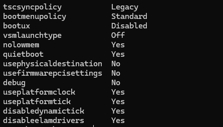

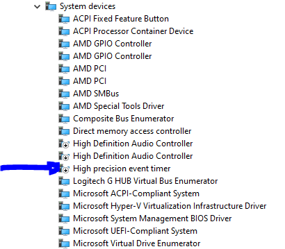

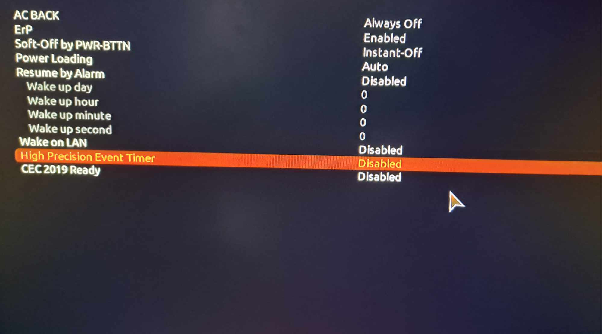

Post by jassine » 29 Aug 2024, 14:37
Slender wrote:
29 Aug 2024, 12:24
you wrong. if hpet is hard disable from bios, and useplatformclock yes it uses ACPI timer with 3.580 clock. You not disable hpet in bios.
and.. dont waste your time with that.
that is affect but it not fix.
I did disable it from bios, i did what u said, how am i wrong ?
os hpet.PNG (14.73 KiB) Viewed 5191 times
os hpet 2.PNG (13.39 KiB) Viewed 5191 times
