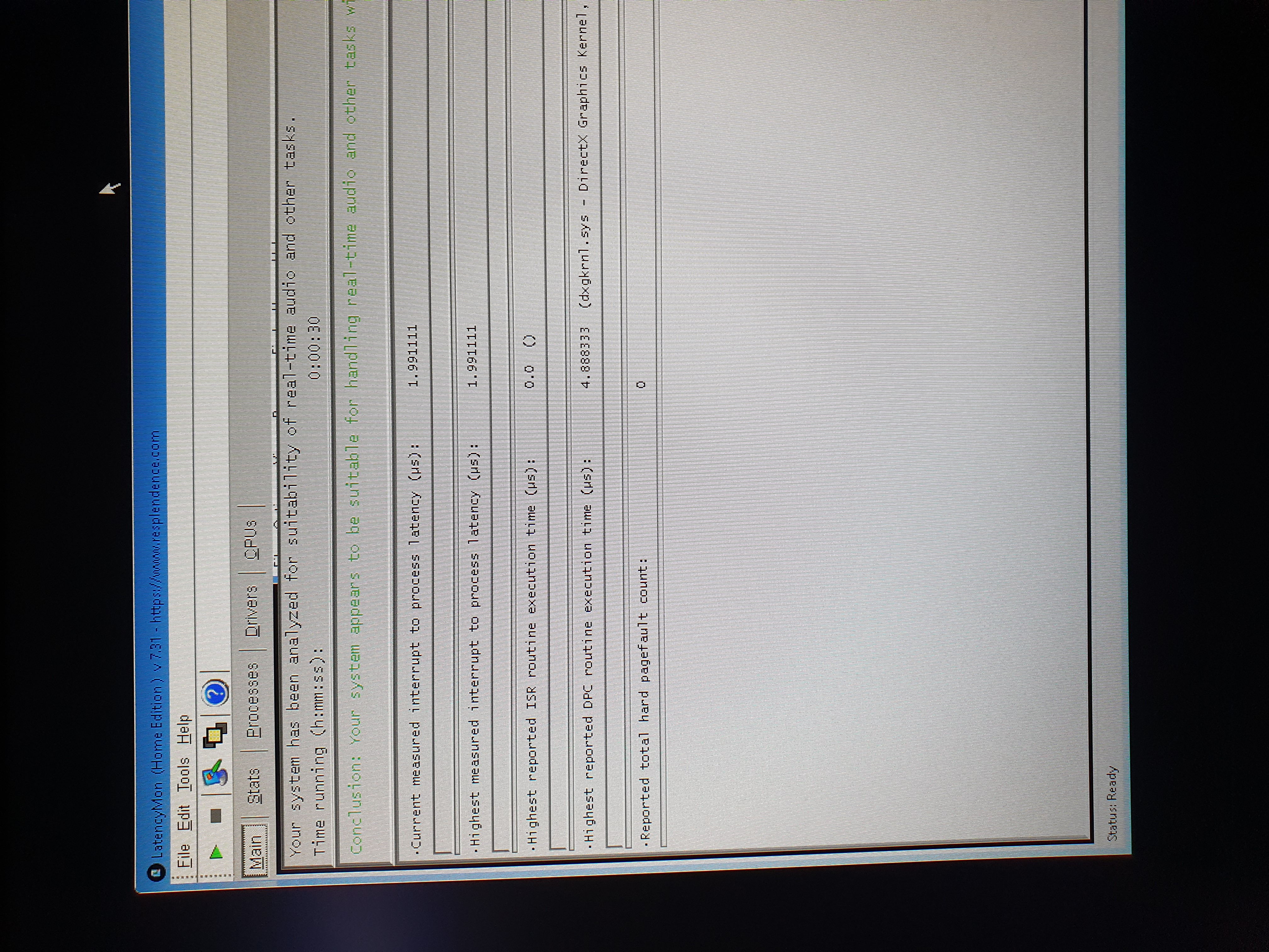

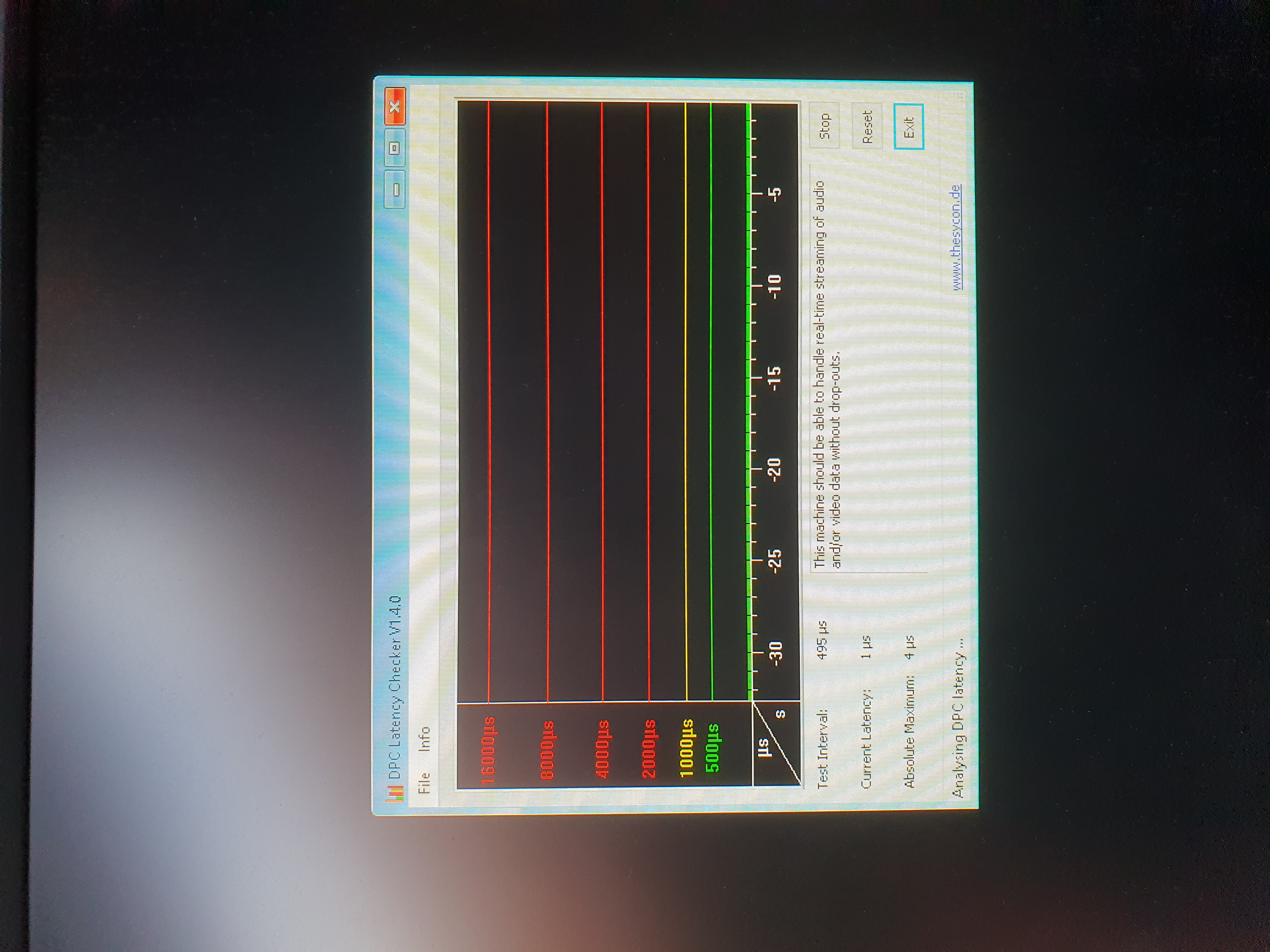

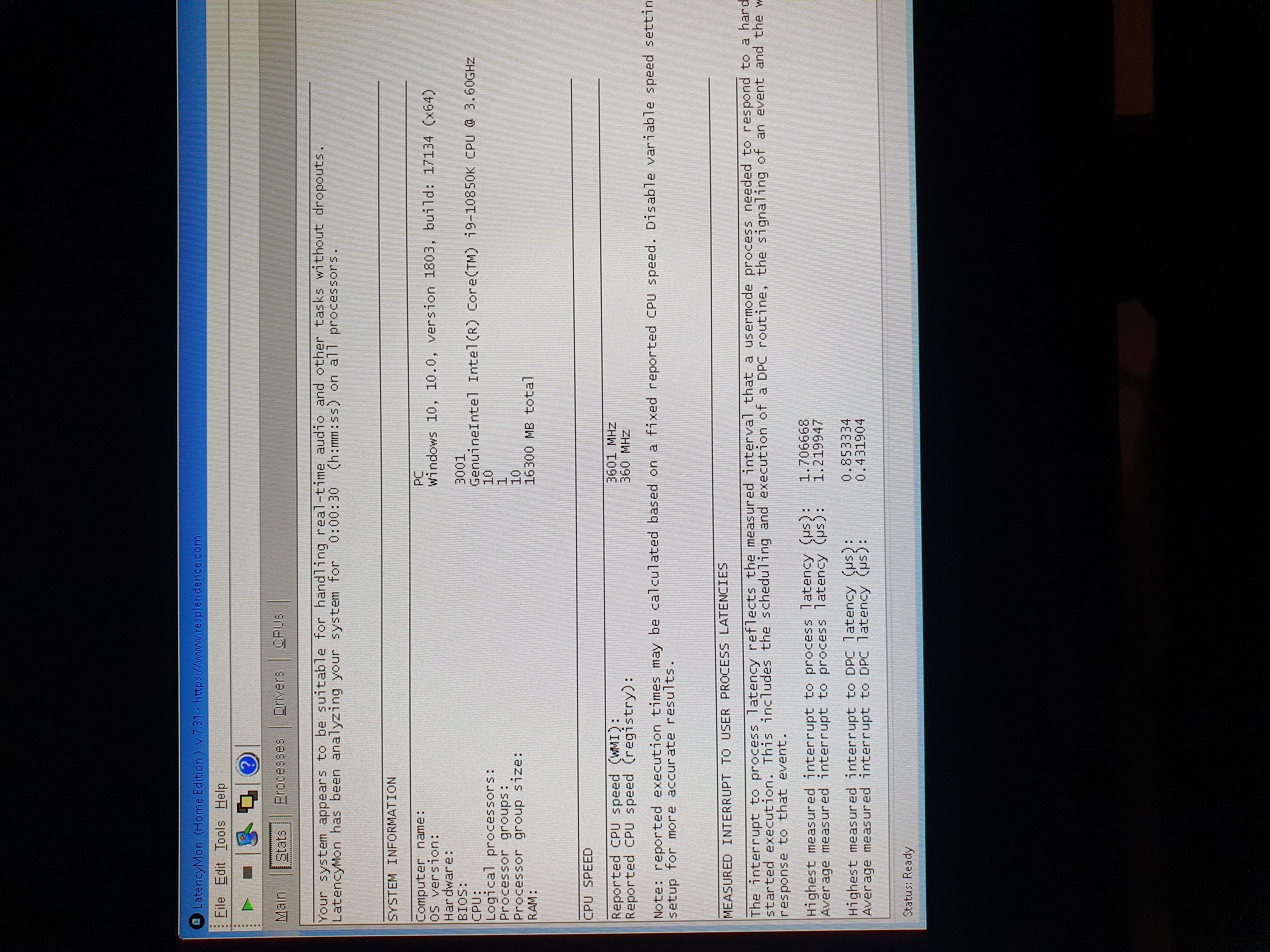

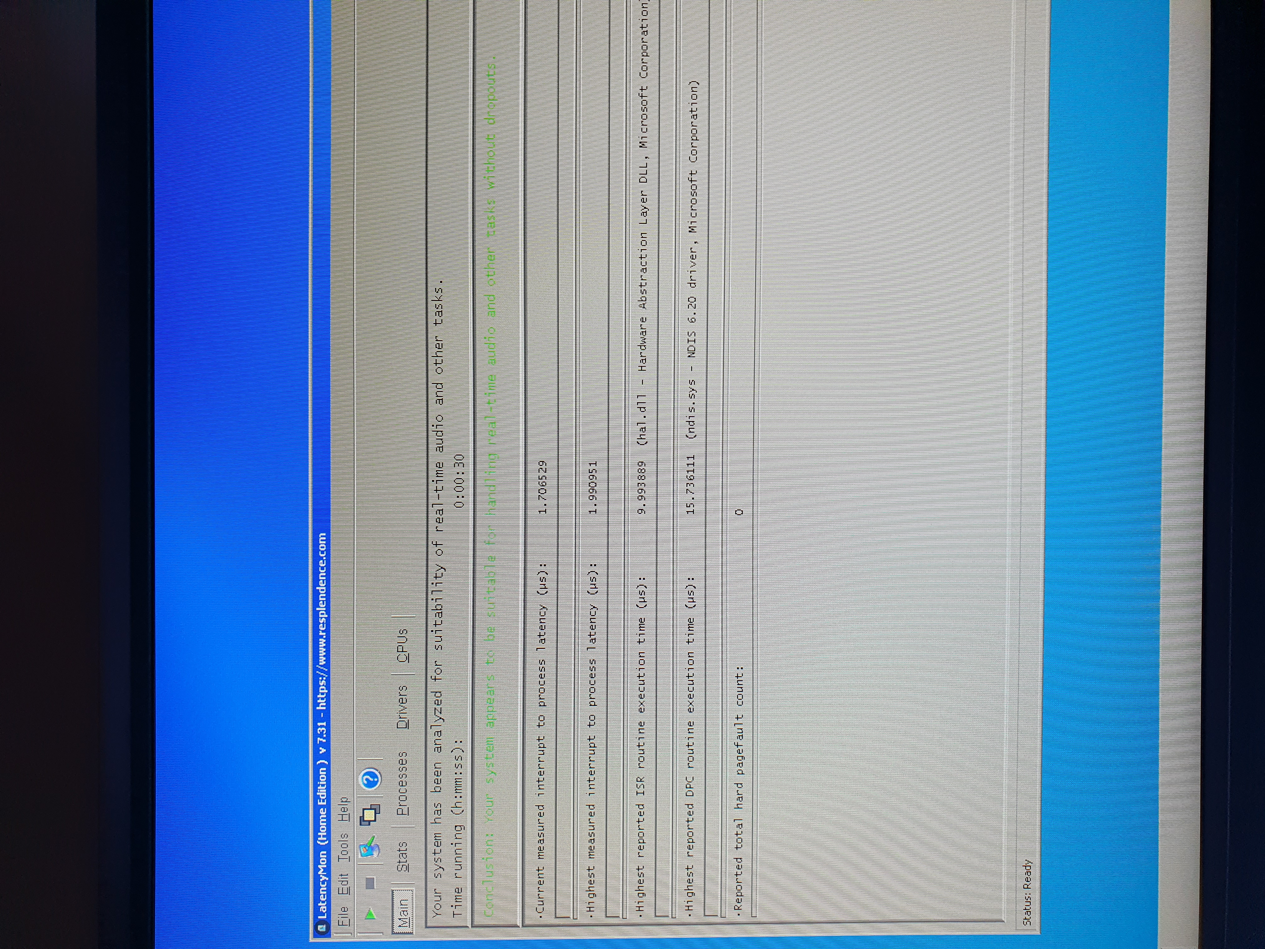

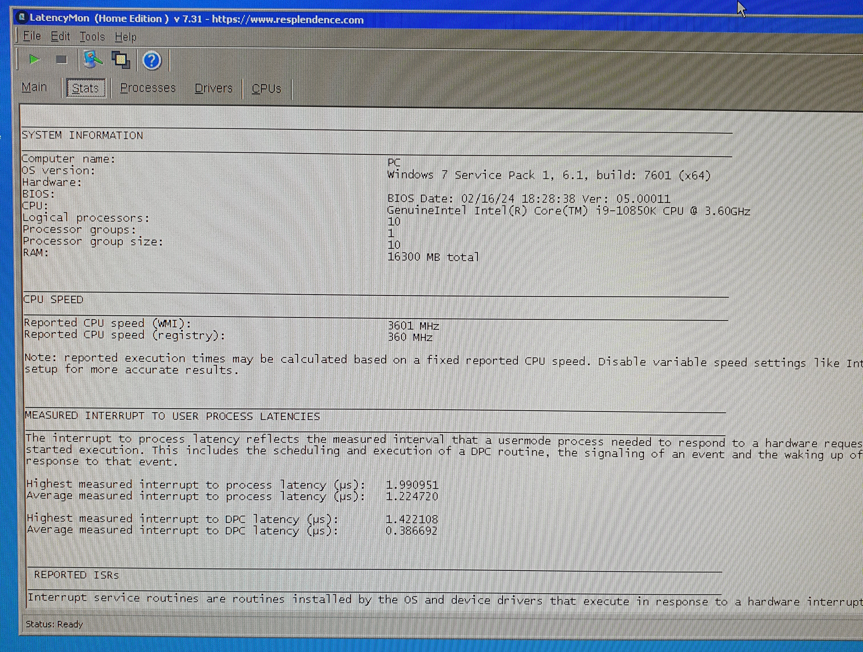

I'm going to make 2 comments as I can't send the pictures in just one. I do test things by feel as well because there are settings that push for lower latency but absolutely ruin performance. I use latencymon just to check but I know it's not really a measure of anything, just confirms the tweaks to have a positive effect. Xperf can be used and many people claim it to be the appropriate tool. For you gpu you can use this: https://github.com/valleyofdoom/AutoGpuAffinity
