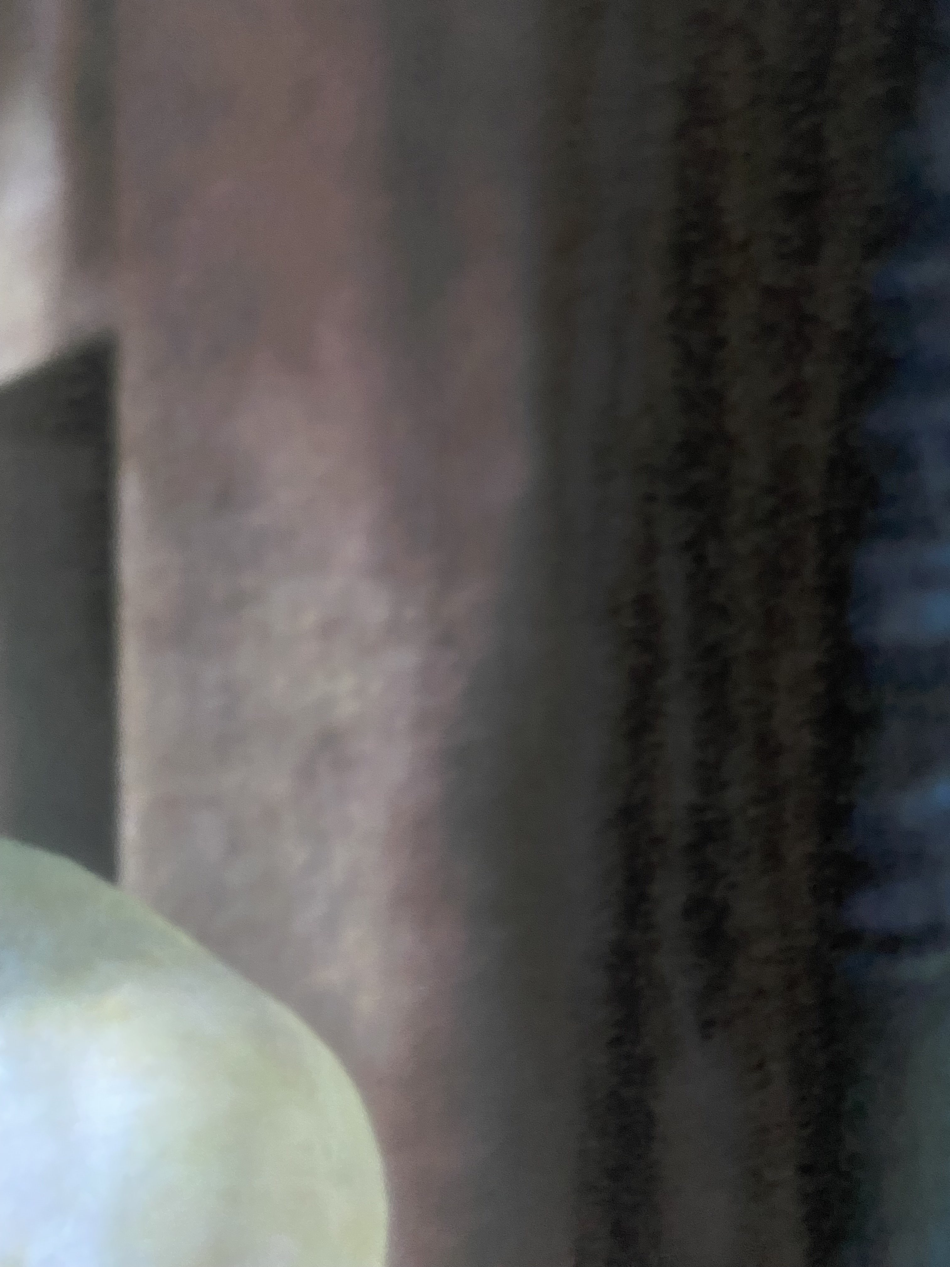

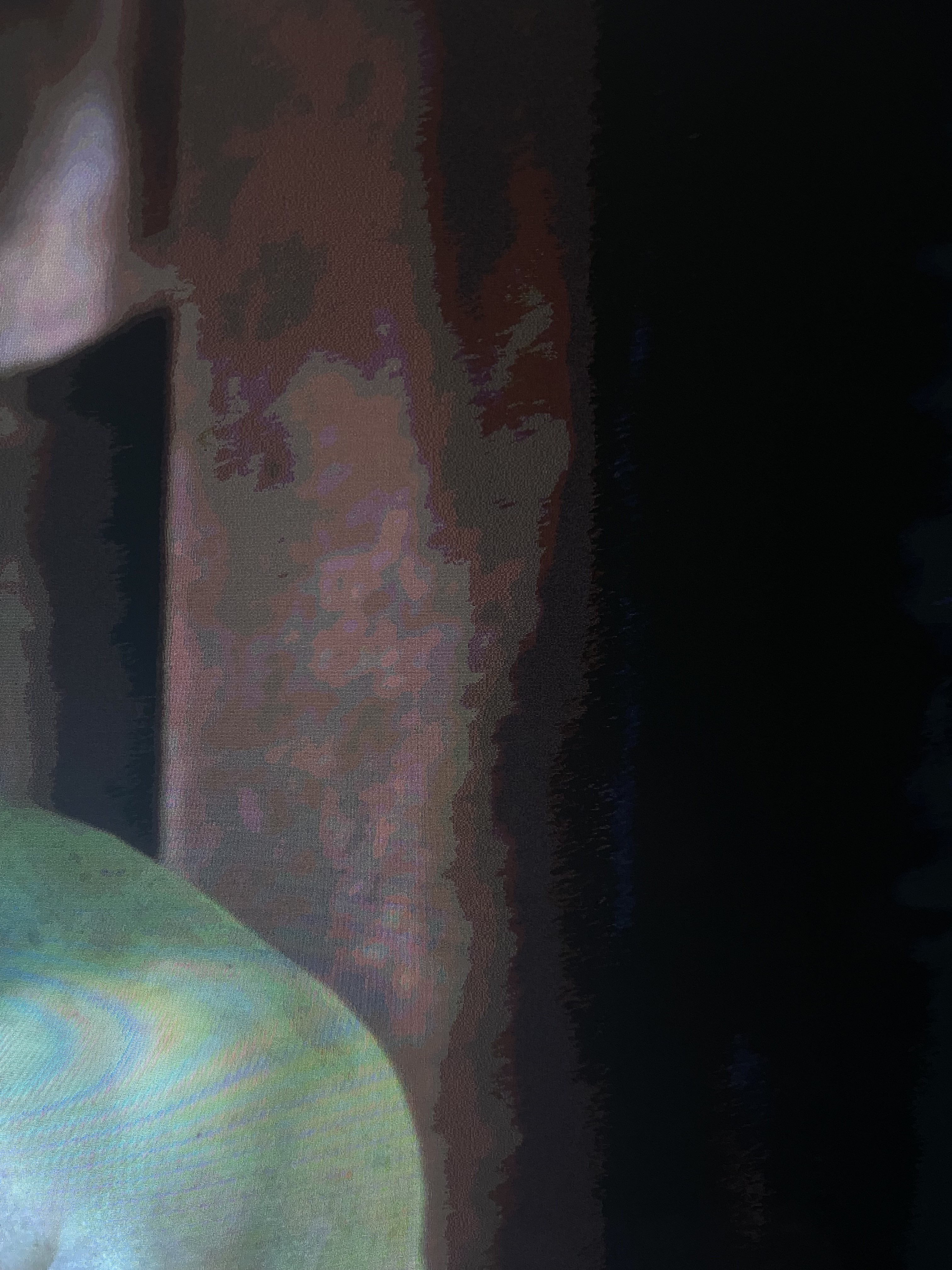

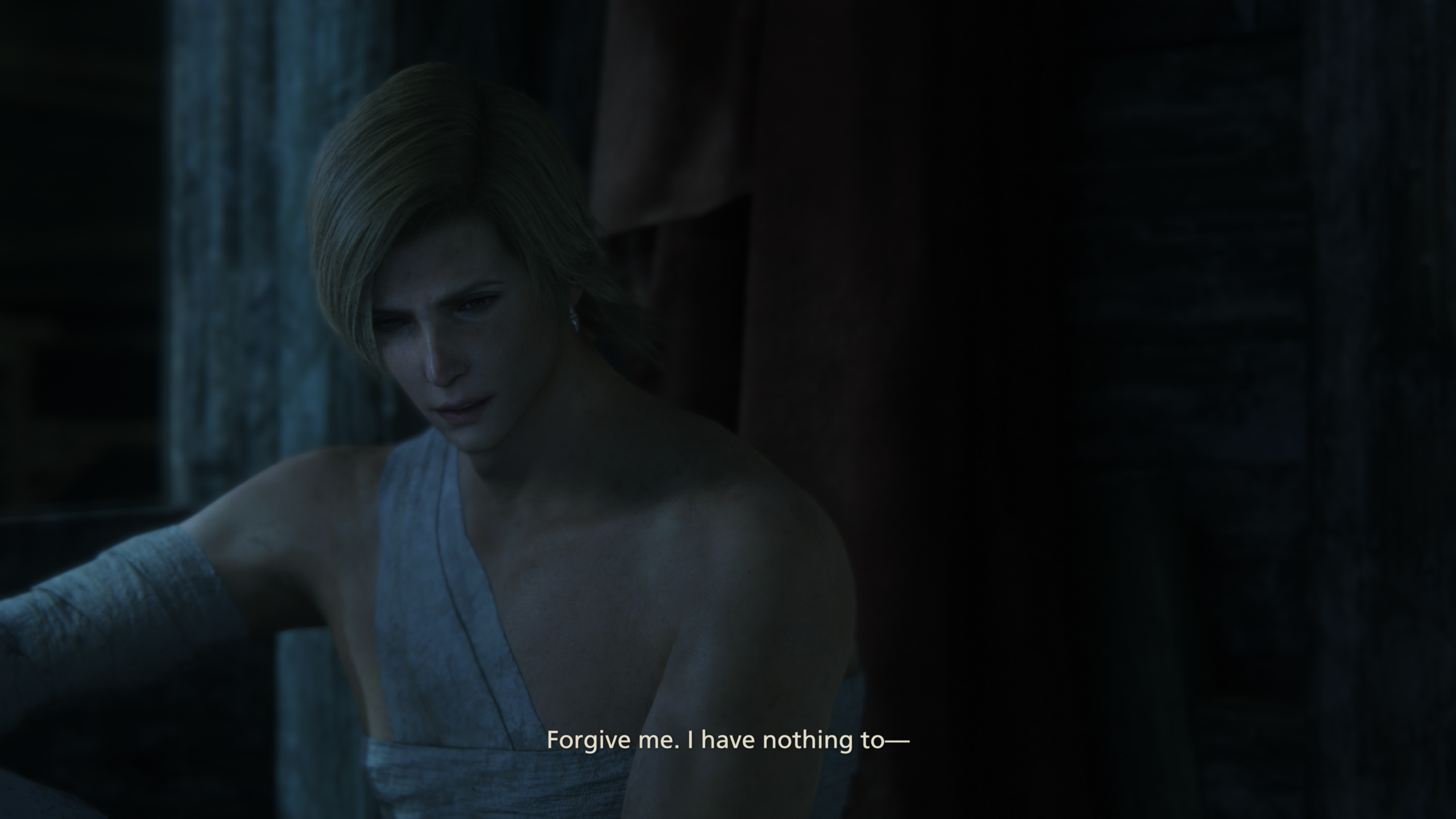

Rewire
- Posts: 15
- Joined: 01 Dec 2024, 04:43
Re: Asus XG27AQDMG Discussion
It's not fixed. You can mend it by doing what the original poster did with nosrgb, but even then I encountered some flaws in actual gameplay scenarios. For example this image from FF16 although there is less "black crushing" there is definitely something wrong with the image. You also lose the oversaturation and vivid colors from base Racing Mode and using Saturation on OSD doesn't really match up with it somehow.Teccaneena wrote: ↑01 Dec 2024, 10:25They mentioned shadow detail for HDR in the notes - does anyone know if the black crush in SDR is fixed?
- image (1).jpg (4.87 MiB) Viewed 17068 times
- image.jpg (3.81 MiB) Viewed 17068 times
- image.png (3.26 MiB) Viewed 17068 times
