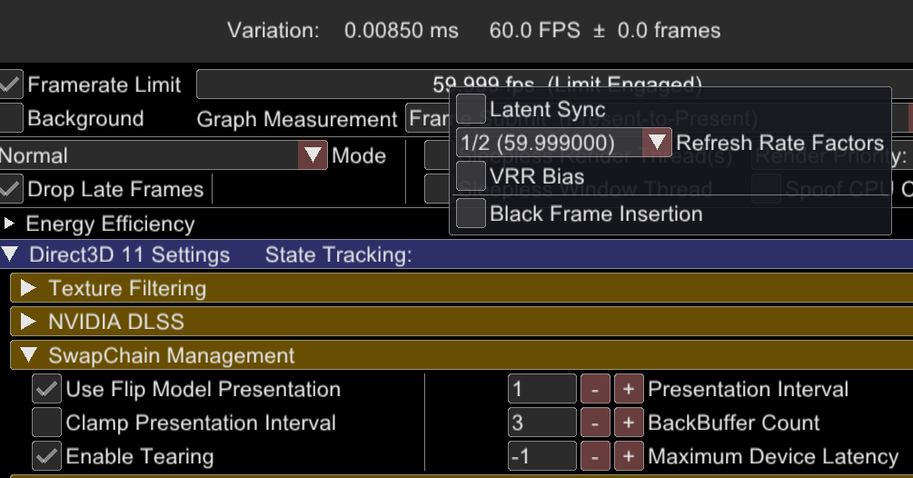

Fractional v-sync will disable g-sync. That's by design and you can't prevent it. With that said, I think the reason why the stutters go away with 1/2 vsync is that your display is not good at VRR. Try this:
Disable g-sync and use Special K to set an exact 1/2 FPS cap by right-clicking on the FPS value field:
If the stutter goes away, your problem is the display's VRR support itself.
You can also change the "presentation interval" value from 1 to 2, which means 1/2 vsync (it applies immediately and you don't need to restart the game, and for it to work vsync must be set to "use 3D application setting" in the nvidia control panel.)
