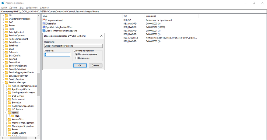

1. Press Win+R and enter the regedit command. In the window that appears, go to the kernel section and create a new Dword32 parameter with the name GlobalTimerResolutionRequests and the value 1 in hexadecimal. Or use a pre-made file with the necessary settings.
That work on w11 and give's your OLD-style timer resolution like in 1709 / 1803 / w7

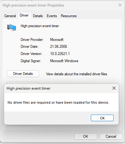

2. Right-click on “Start” and select “Device Manager”. To disable HPET and activate the TSC timer, we must disable the “High Precision Event Timer” in the “System Devices” section; sometimes it is signed as High Precision Even Timer. Right click>>"Disconnect device".
I don't think it does anything since it doesn't have a driver. Disabling devices only works if there is a driver associated with them. Although, I always thought that this gives more accuracy in exchange for smoothness.
Screenshot 2024-12-11 061805.png (26.58 KiB) Viewed 9184 times
