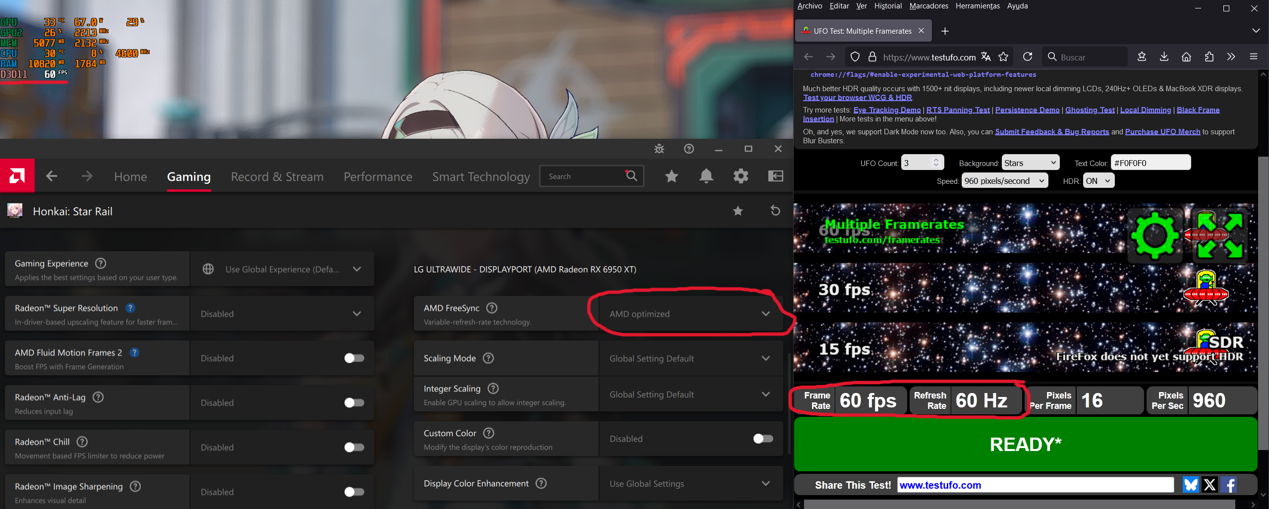

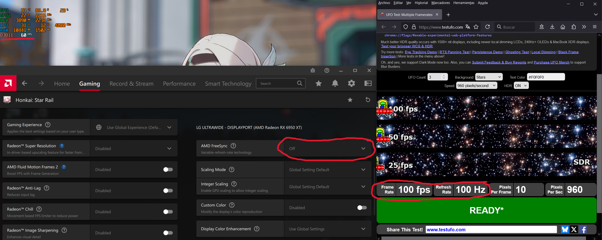

A pretty dumb test I just did was running the game while having TestUFO open in my browser. With the browser window focused and the game running in the background, here’s what happens:
ON:
    FreeSync ON.png (1.42 MiB) Viewed 35364 times
OFF:
    FreeSync OFF.png (1.36 MiB) Viewed 35364 times
You can clearly see the difference in behavior with FreeSync ON vs FreeSync OFF for the game. No changes done on the settings ingame, VSync is still being forced there as the game is capped either to 30 or 60 FPS (up to you). This weird issue started after I updated to 24.6.1. At first, I didn’t even realize what was happening... it just felt like something wasn’t as smooth anymore. After some trial and error, I went back to 24.5.1, and that weird feeling was gone.
I avoided updating the driver for months because of this issue. A couple of days ago, I thought, "Hey, whatever that was must be fixed by now."
Spoiler alert: It wasn’t! :lol:
