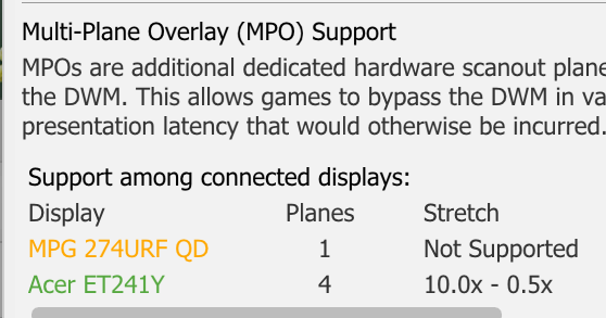

I've installed the SpecialK and here's the info. Seems like it is disabled for my main monitor, but enabled for my Acer/secondary monitor right?
Yeah. That's weird. Are you sure you've set the MPG to be the primary display? Also, are you using HDR mode in Windows? Or 10/12-bit color? Or DSR/DLDSR? All these can disable MPO support which can cause g-sync to stop working in borderless.
Keep in mind that MPOs are only enabled on one display. But it should be the primary, not the secondary. But for you it seems that for some weird reason, it's the other way around.

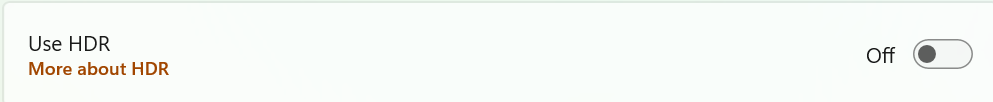

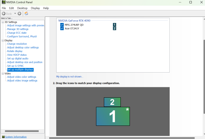

Yes, it's set as primary display, as shown in image below.
My HDR is turned off.
I'm not using DSR/DLDSR, my NVCP don't even have those option somehow. I'll try search around why is this, but this is separate matter though.
For all those settings, does it also cause GSync to stop working in borderless in single monitor mode? Because I able to get it work in single monitor mode.
