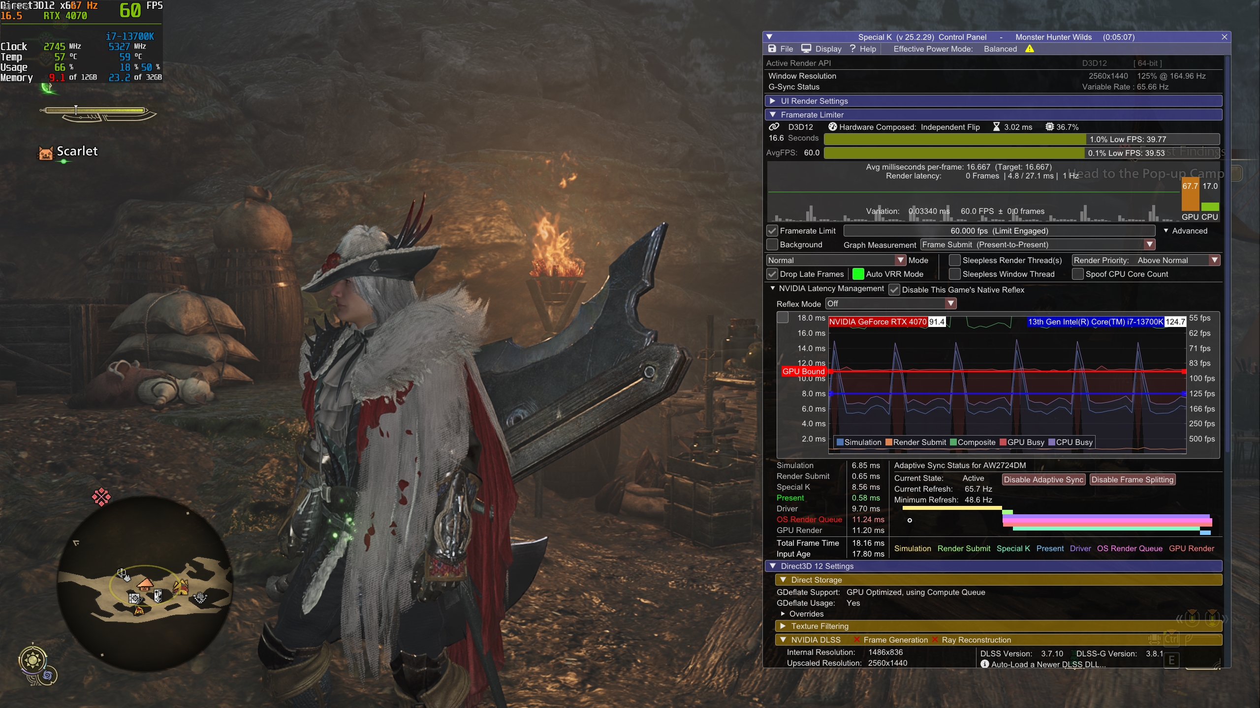

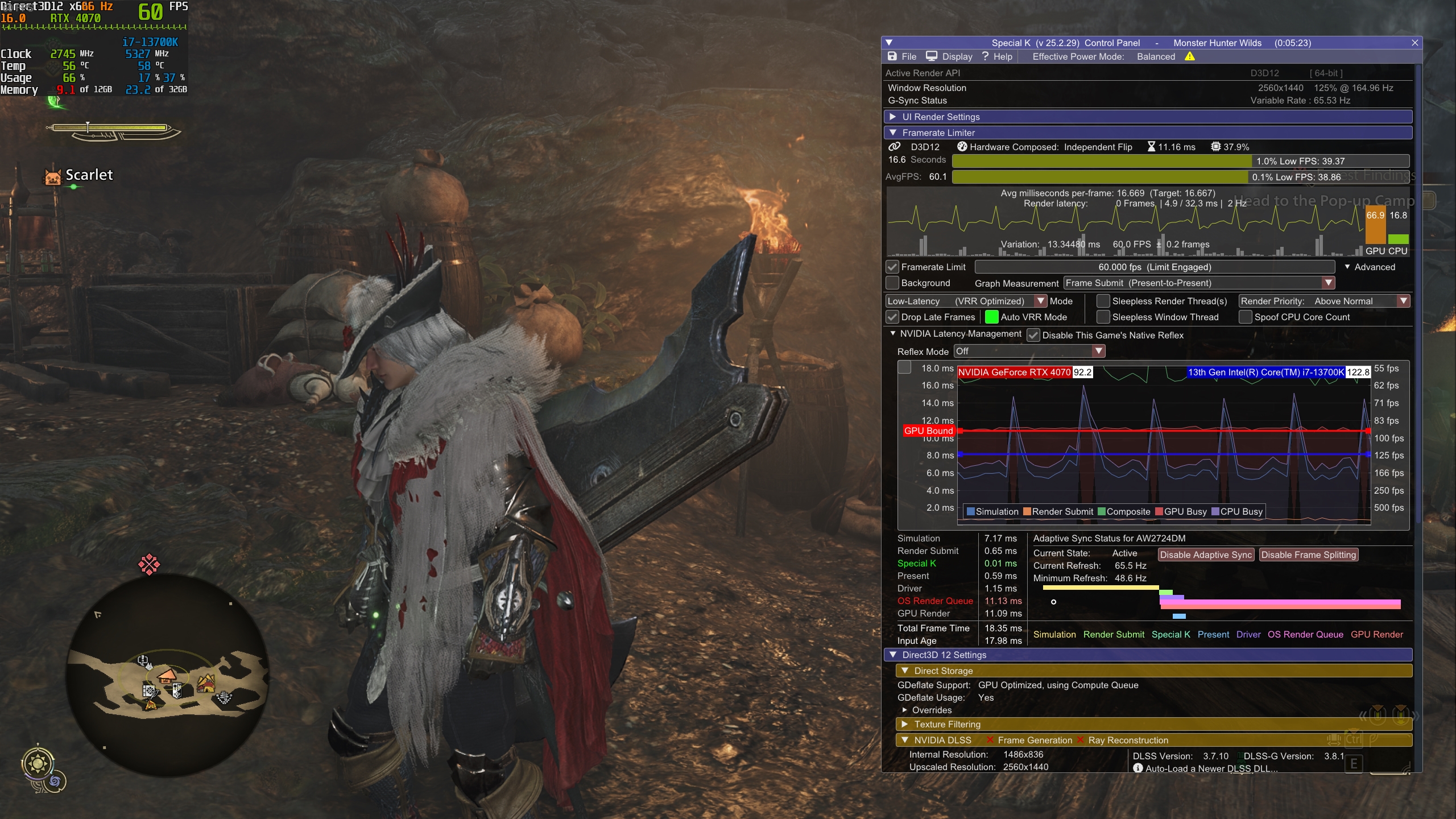

So, I tested out Special K since it seems to be safe for Wilds.
The HZ monitor still is at 66Hz using Special K's Normal limiter (I also read somewhere else that there is a problem with Reflex in this game, so I disabled it through Special K as well)
I also tried with the Low Latency (VRR optimized limiter), which seemed to show the same cyclical spikes.
Oddly, I don't think I can notice a difference between the two limiters, but it still feels a little off using them because of the Hz mismatch I think. The Special K graph also shows heavy simulation time spikes for both.
VRR Optimized limiter: Normal limiter:
