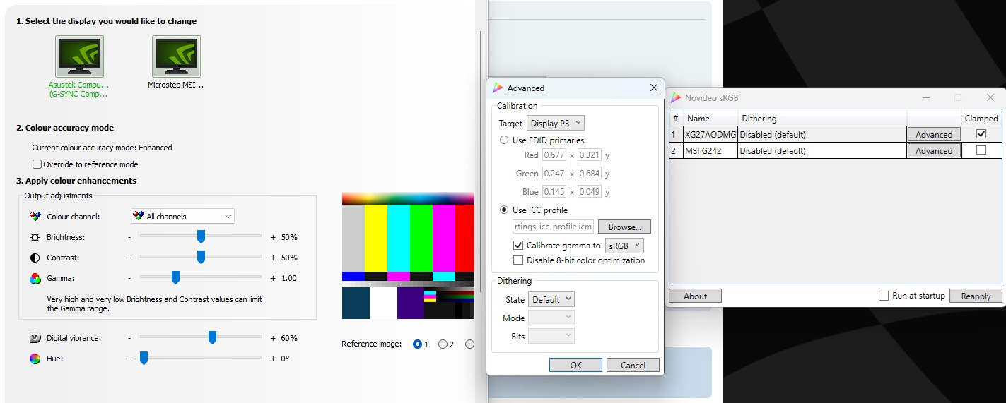

Regarding those who want to use the Nosrgb method yet still retain the vibrant and popping colors of Wide-Gamut/Racing Mode, you can use these settings. On lagom test 1 almost blends in with background and all other squares are visible, I haven't seen any gradient issues in the black to white gradient test either. I personally added 10% Saturation through Nvidia control panel on top, but you can do it on monitor OSD too it doesn't really matter.
