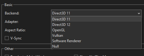

- RealNC
- Posts: 4634
- Joined: 24 Dec 2013, 18:32
Re: Help Understanding G-Sync Windowed 40fps behavior
Vulkan?
- jorimt
- Posts: 2641
- Joined: 04 Nov 2016, 10:44
- Location: USA
Vulkan is indeed an available backend in Dolphin, but I was testing with DX11 in this case:
- dolphin-backends.jpg (30.44 KiB) Viewed 9436 times
(jorimt: /jor-uhm-tee/)
