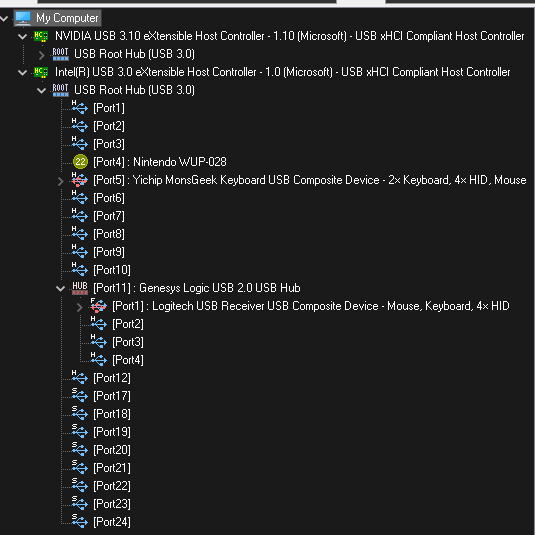

Hi how can i do this type of testing myself? recently got an 8k keyboard and already have a 1k mouse so im curious how i can test this to get the best ports for me
juhhh
Joined: 19 Aug 2025, 12:11
Re: TIP: Always put high-Hz keyboard and high-Hz mouse on SEPARATE DEDICATED USB CHIPS.
Post by juhhh » 20 Aug 2025, 12:30
for now ive put my mouse into the 2.0 ports at the top of my case, and disabled my gamecube controller adapter when im not using it. this is just raw guessing though cuz idk how to test. io know ppl use mouse tester but the on i find from google search doesnt look like the results ppl r sharing here.
