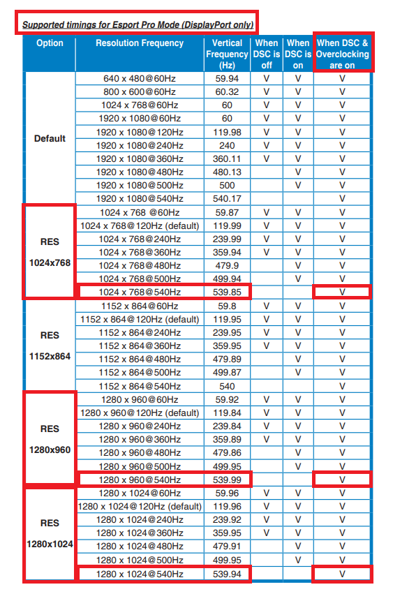

I'd love to try esports pro mode on valorant but it just gives me black bars on the top and bottom of my screen regardless of any scaling option in nvidia control panel so I'm stuck with default. Any ideas? This monitor drives me fucking nuts lol.naporitan wrote: ↑04 May 2025, 12:41Screenshot 2025-05-05 024042.pngihatedscc wrote: ↑13 Dec 2024, 06:16Hello so I'd like to share my dilemma with DSC and mouse input feeling. I have recently purchased the 540hz pg248qp and a RTX 3070TI because my 1080ti has no DSC capability so it capped the monitor to 500hz & 4:2:2 chroma subsampling; the picture quality was also hella ugly and I wanted to get a new gpu to rectify it. Now I have both GPUS, I get into a game with the 3070ti installed and instantly I can feel my cursor feel very heavy and my input delayed. Then I suspected it could be the DSC, I swap my old 1080ti back to the system and everything seems fine again, I swap both gpus again for 6 times already and I can notice the same input lag on this rtx card. I've also tried tweaked nvidia profiles on both cards and it's still the same. My system is also fully capable of running 540hz with high end parts. I'd like to know if anybody else experiences this issue.

viewtopic.php?f=10&t=14611&p=115627#p115627BlurWickd wrote: ↑08 May 2025, 16:23I'd love to try esports pro mode on valorant but it just gives me black bars on the top and bottom of my screen regardless of any scaling option in nvidia control panel so I'm stuck with default. Any ideas? This monitor drives me fucking nuts lol.naporitan wrote: ↑04 May 2025, 12:41Screenshot 2025-05-05 024042.pngihatedscc wrote: ↑13 Dec 2024, 06:16Hello so I'd like to share my dilemma with DSC and mouse input feeling. I have recently purchased the 540hz pg248qp and a RTX 3070TI because my 1080ti has no DSC capability so it capped the monitor to 500hz & 4:2:2 chroma subsampling; the picture quality was also hella ugly and I wanted to get a new gpu to rectify it. Now I have both GPUS, I get into a game with the 3070ti installed and instantly I can feel my cursor feel very heavy and my input delayed. Then I suspected it could be the DSC, I swap my old 1080ti back to the system and everything seems fine again, I swap both gpus again for 6 times already and I can notice the same input lag on this rtx card. I've also tried tweaked nvidia profiles on both cards and it's still the same. My system is also fully capable of running 540hz with high end parts. I'd like to know if anybody else experiences this issue.
