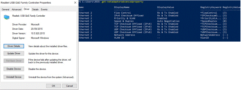

https://imgur.com/a/Y1Oivhs
This is the one I had by default, then it updated to a 2024 driver- much worse, I tried another 2018 driver that I found online but the default 2016 driver was the best. It's strange that you have a driver from 2012 and not the same one as me because I got this same version on different windows builds

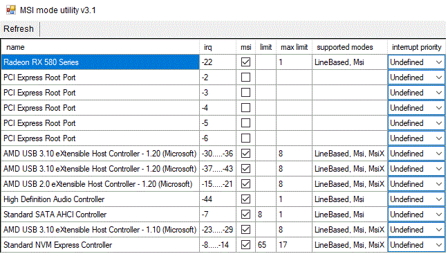

ok guys i just want to share my expierience i wrote it in another topic but i finaly find this one,so i buy the "TP-Link UE300, USB 3.0"
and first when i plug it as i will show the driver was 2015 with 8 or 10 options,and then i play premier and it was ok,but when i update to the latest driver for my device,version 5,the driver is from 2023,and it has more options,but its worse,i just want to show screens,and my msi utility how it looks,because its pluged to usb i cant change priority msi mode on or off ?

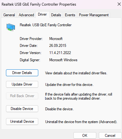

aglooka12
Joined: 17 May 2025, 08:03
Post by aglooka12 » 17 May 2025, 08:26
Guys can u help me with this how can i get back to the oldest driver version im uninstalling on device manager but the ethernet adapter still showing up like this.
