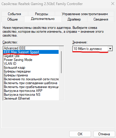

Guys, try limiting EEE Max Support Speed to 10 Mbps.
Here's what people write about this setting on the Internet: EEE max support speed usually indicates the maximum network speed (e.g. 1 Gbps or 10 Gbps) up to which EEE technology can be applied. For example, if you have a switch with EEE functionality and its "EEE max support speed" is 1 Gbps, this means that EEE can only be activated on networks with a maximum speed of up to 1 Gbps.
Now let's imagine that we have a network device, such as a switch, and its specifications specify a parameter called "EEE max support speed". If this parameter is, for example, 1 Gbps, this means that EEE will only work on this device for networks where the maximum speed does not exceed 1 Gbps. If the network is running at 10Gbps, EEE will not be activated and the device will operate at full power without turning on power saving mode.
Wherever I look at various video settings, for some reason everyone always recommends setting it to 1 Gbps or more.
- 1
- Снимок экрана 2025-06-07 155010.png (22.87 KiB) Viewed 21821 times

gideonmontes
- Posts: 51
- Joined: 25 Jun 2023, 07:59
No, I have a wifi module from Intel installed.
In general, I fixed the floating mouse by installing all the drivers from AMD (chipset), and the desynchronization by changing the EEEMaxSupportSpeed setting to 10 Mbit/s, thereby disabling the energy-saving function. Now they are constantly trying to kick me from the cs2 server.
- 1
- Снимок экрана 2025-06-08 102227.png (58.15 KiB) Viewed 21731 times

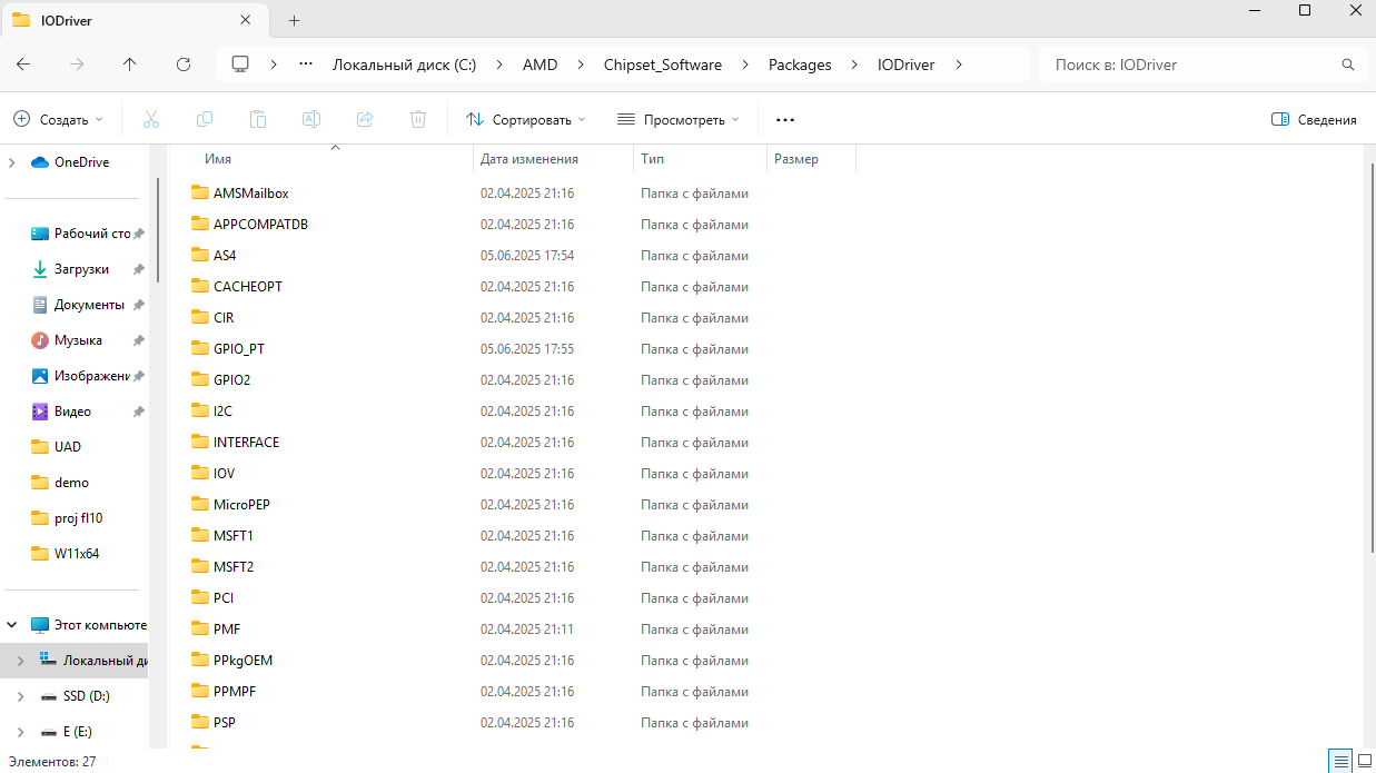

gideonmontes
- Posts: 51
I installed the driver from here: C:\Program Files (x86)\AMD\Chipset_Software, by running the shortcut "AMD_Chipset_Drivers", and also additionally installed all the drivers from here: C:\AMD\Chipset_Software\Packages\IODriver
I don’t know, but perhaps Intel has the same folders, I gave my 10700kf to my wife’s father, I’ll check when I get there.

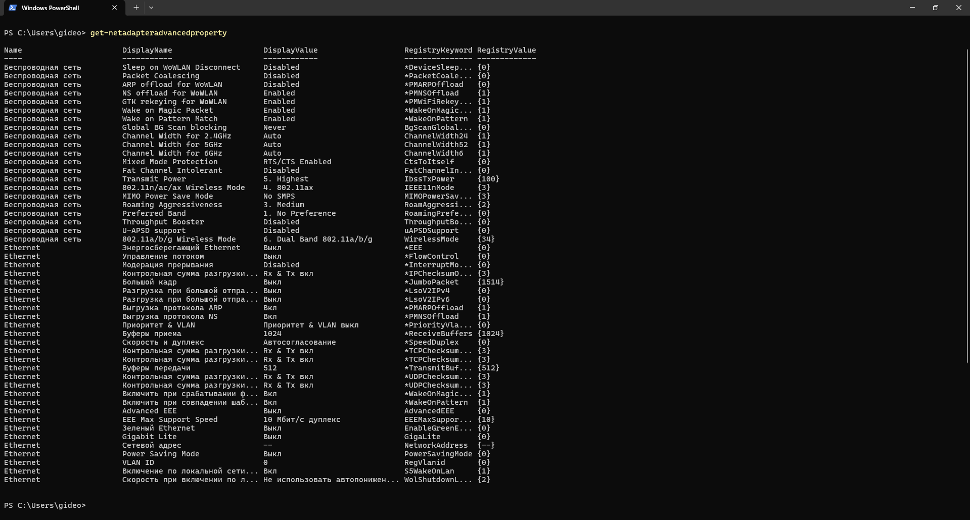

JimCarry
- Posts: 586
- Joined: 24 May 2024, 20:01
- Location: csgo
1.you have realtek 2.5gb on board nic right ?gideonmontes wrote: ↑08 Jun 2025, 00:25No, I have a wifi module from Intel installed.
2.can you post your whole pc parts
3.what version is your nic driver,because when i was using on board nic i was with the same but i did not have that option
4.can you open powershell and type this: "get-netadapteradvancedproperty" and post the results here?

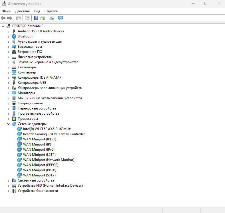

gideonmontes
- Posts: 51
1. Yes, that's right, it's an integrated network card.
2. 7800x3d, rtx 3070, 32GB RAM (6400), benq xl2411p, gigabyte b650 aorus elite ax v2.
3. Version 1125.25.20.2025 from 04/23/2025. The driver was downloaded from the official Realtek website.
- 1
- Снимок экрана 2025-06-08 122629 4444444444.png (218.6 KiB) Viewed 21707 times
JimCarry
- Posts: 586
- Location: csgo
thanks i am using usb nic right now,but i also have on board 2.5gb realtek but on asus mb,and when i install last driver from realtek site.i did not have so much options like you,so you are saying you only need chipset drivers,and to change EEE Max Support Speed to 10 Mbps ?gideonmontes wrote: ↑08 Jun 2025, 02:271. Yes, that's right, it's an integrated network card.
gideonmontes
- Posts: 51
That's right, I didn't change anything in Windows 11, I just turned off some personalization settings.
