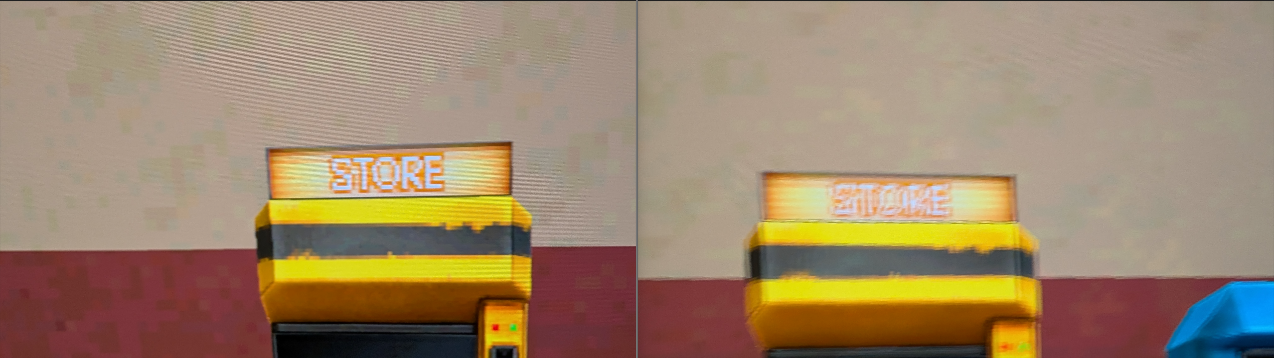

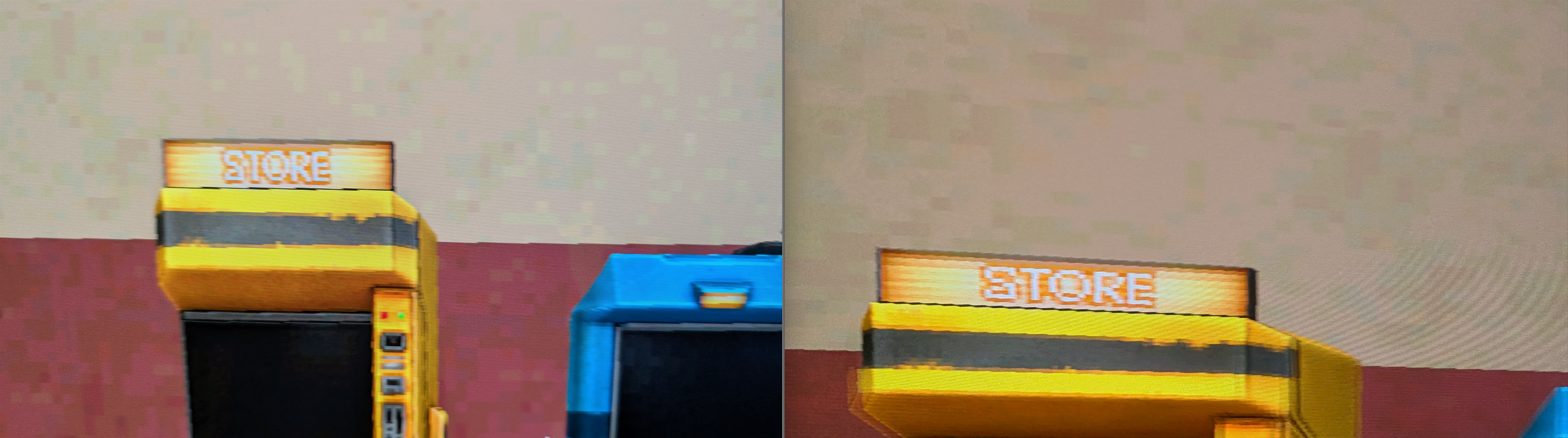

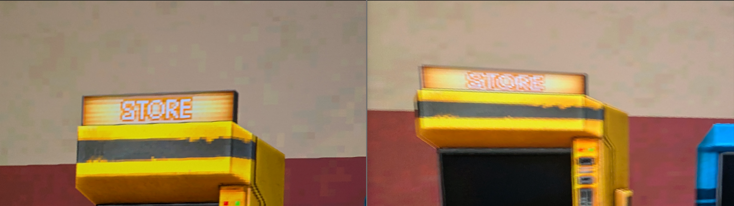

These images are in the ULTRAKILL sandbox. Left is strafing, right is strafing and panning. I'm using a controller so I know there's no polling rate funny business going on, and I am using PresentMon to track FPS so I know I can hold a consistent 600 uncapped.
479.99 Hz, ELMB off
239.97 Hz, ELMB on
120 Hz, ELMB on
As you can see, in all cases just strafing looks great, but with 479.99 and 239.97 as soon as there is any panning the STORE text becomes almost unreadable. This is the sort of thing I would expect ELMB to fix, and it does when selecting 120 Hz. However, there is no option to select 240 Hz in Windows settings, and I can see that selecting 119.88 Hz has similar motion clarity issues to 239.97. (The OSD shows 120Hz at 119.88 and 120, but the difference in quality is night and day)
