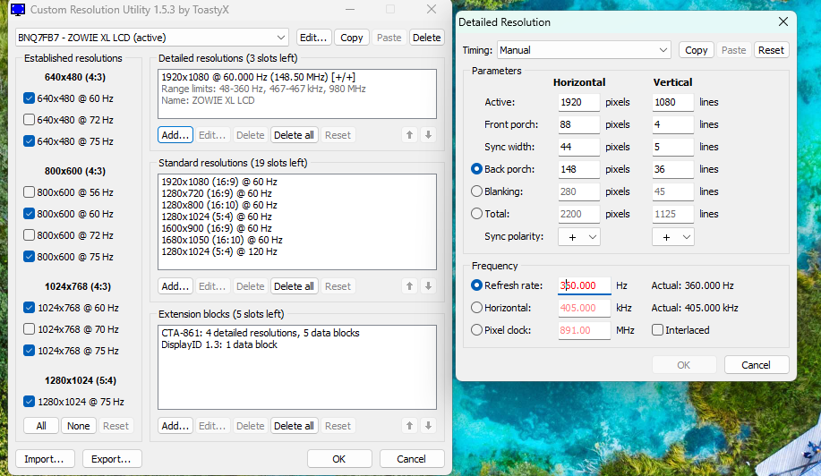

Why does it get red when i set 360hz?

I don't know that application but does it get red when you use 359-358 ? The actual refresh rate is 1-2 lower.

If the cru program shows "range limits" via DisplayPort, then the monitor will always have a delay like when adaptivesync is enabled. Even if it is disabled via the monitor and in the driver. And it will never work clearly, even like the old 60hz monitors, where there were no "range limits". Why did such a reputable company as benq add range limits to the monitor's edid in principle? If it is disabled? Just to have an extra delay? I don't understand. This is the worst implementation of vrr at the edid monitor level, which makes your mouse float and change its sensitivity. If you manually delete the "range limits" you will see how the game should really work, but it will only work until the reboot, then it will get even worse than it was. The only monitor I've found that works properly and doesn't have “range limits” is the Samsung odyssey g4 g40b 240hz, so far the best I've seen is that it works the same way as the old benq zowie 2411p 144, which also didn't have a cheap gsync analog in the edid monitor. For everyone who shows range limits in cru, you will never be able to achieve a perfect result, because this is an adaptive link that does not turn off. And with sharp turns, you will tear up the picture and everything will float.
