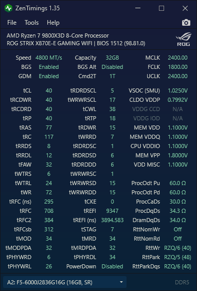

ChristophSmaul1337
Posts: 114
Joined: 11 Feb 2024, 21:01
Re: Input lag and desync problem due to RAM?
Post by ChristophSmaul1337 » 07 Aug 2025, 11:15
Dcyker wrote: ↑
07 Aug 2025, 07:49
I don‘t have the MCH Full Check Option on my x870e-e, can I do your method anyways with just using Fast Boot enabled/disabled?
Sure. It will still work, it's just something I like to have on on ASUS boards, but it's not needed. Fast Boot should be there though, every somewhat recent board/BIOS should have that. Just make sure the memory is (re)trained under the worst-case scenario with high temperatures.
Dcyker
Posts: 10
Joined: 01 Jun 2023, 03:41
Post by Dcyker » 07 Aug 2025, 11:41
ChristophSmaul1337 wrote: ↑
07 Aug 2025, 11:15
Dcyker wrote: ↑
07 Aug 2025, 07:49
I've done your Method and it's literally the same timings as before my ram didnt go past 45C, I am not using EXPO.
ChristophSmaul1337
Posts: 114
Post by ChristophSmaul1337 » 07 Aug 2025, 14:28
Dcyker wrote: ↑
07 Aug 2025, 11:41
Great! Now you know for sure that temperature related instablilty is not a concern and you can continue troubleshooting elsewhere. Objective achieved. Also the timing reader tool you use doesn't show every single timing and subtiming, obviously. There might still be subtimings that have been changed by BIOS when training. It doesn't hurt leaving it like this when moving forward with troubleshooting elsewhere.
