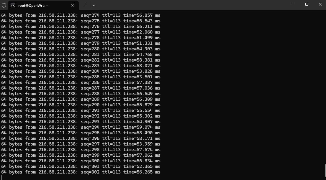

I have Archer C6 router with openwrt
Via SSH on my router i ping google servers while testing my speed on speedtest and results are ~ 50ms. Super stable.

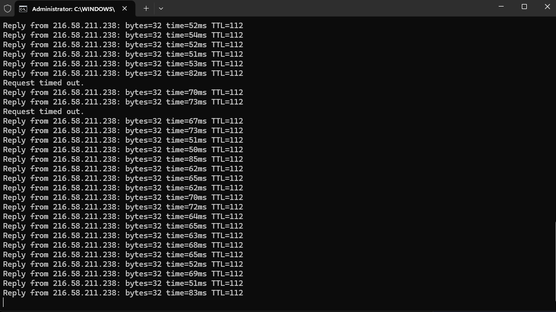

BUT when i ping google servers via cmd on my PC while using speedtest my results are awful. It jumps from 50 to 90 to 120 to 50 to 60 to 90 and so on.
My question is: why my router doesn't have any kind of bufferbloat but my PC is terrible in terms of bufferbloat.
Can you guys do the same test?
1) Start pinging google.com directly from your router and start speedtest.
2) Start pinging google.com directly from your PC and start speedtest.
Post your results here
My results:
Router
PC

This could be Wifi bufferbloat. You didn't state which version of OpenWrt you're using so I can't say for sure. Check out Question 5.3 in the Bufferbloat FAQs (I can't post links as a new user. Google for them)
How far are you from the router? Speeds decrease and latency increases as you move farther away.
I suggest using the Crusader network test (Google for it) on your local network. It's pretty easy to set up.
  • You connect one computer (a laptop, or even a Raspberry Pi) to the Ethernet LAN port of your router: run the server on that machine.
  • Then run the Crusader client on your Windows box, and test against the Crusader server you just set up.
I'll be curious to hear what you learn

i am on ge cable. playing fps competitive gams on wifi is really stupid tbh :D
