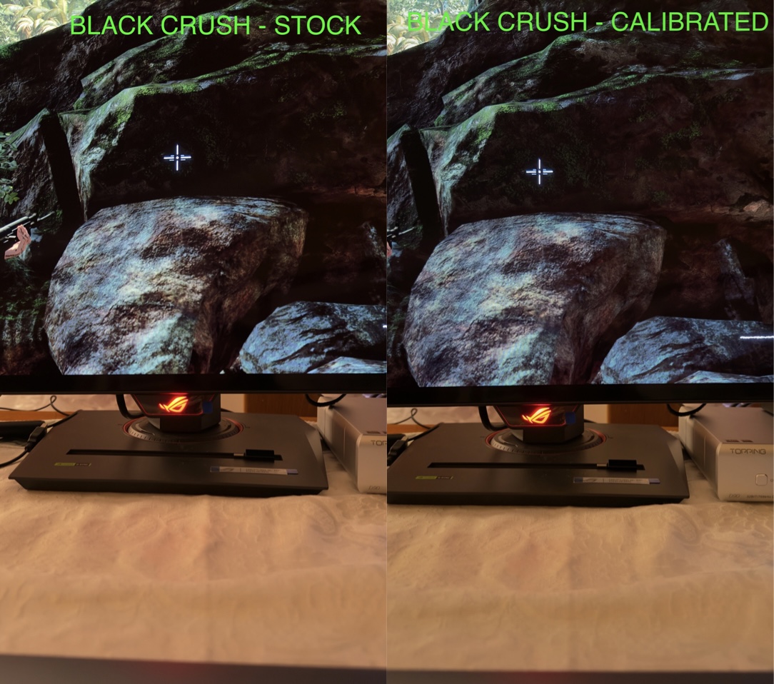

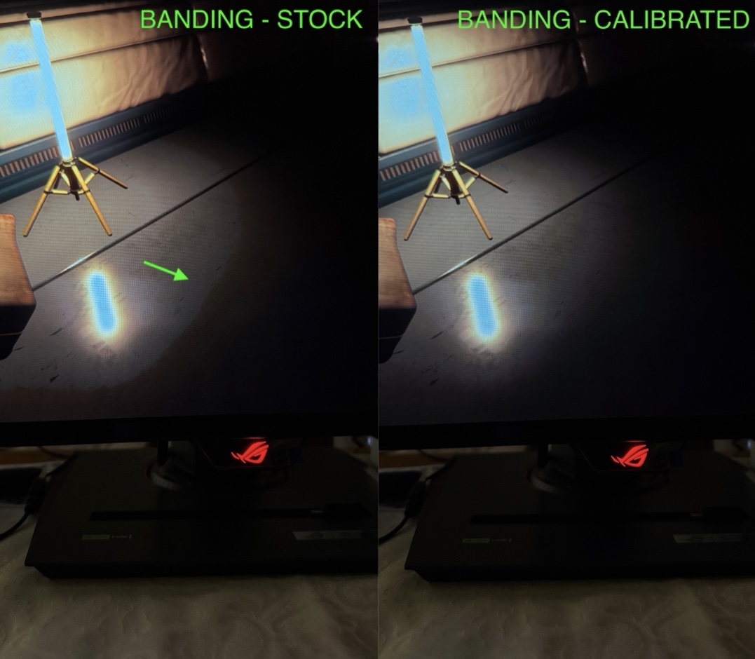

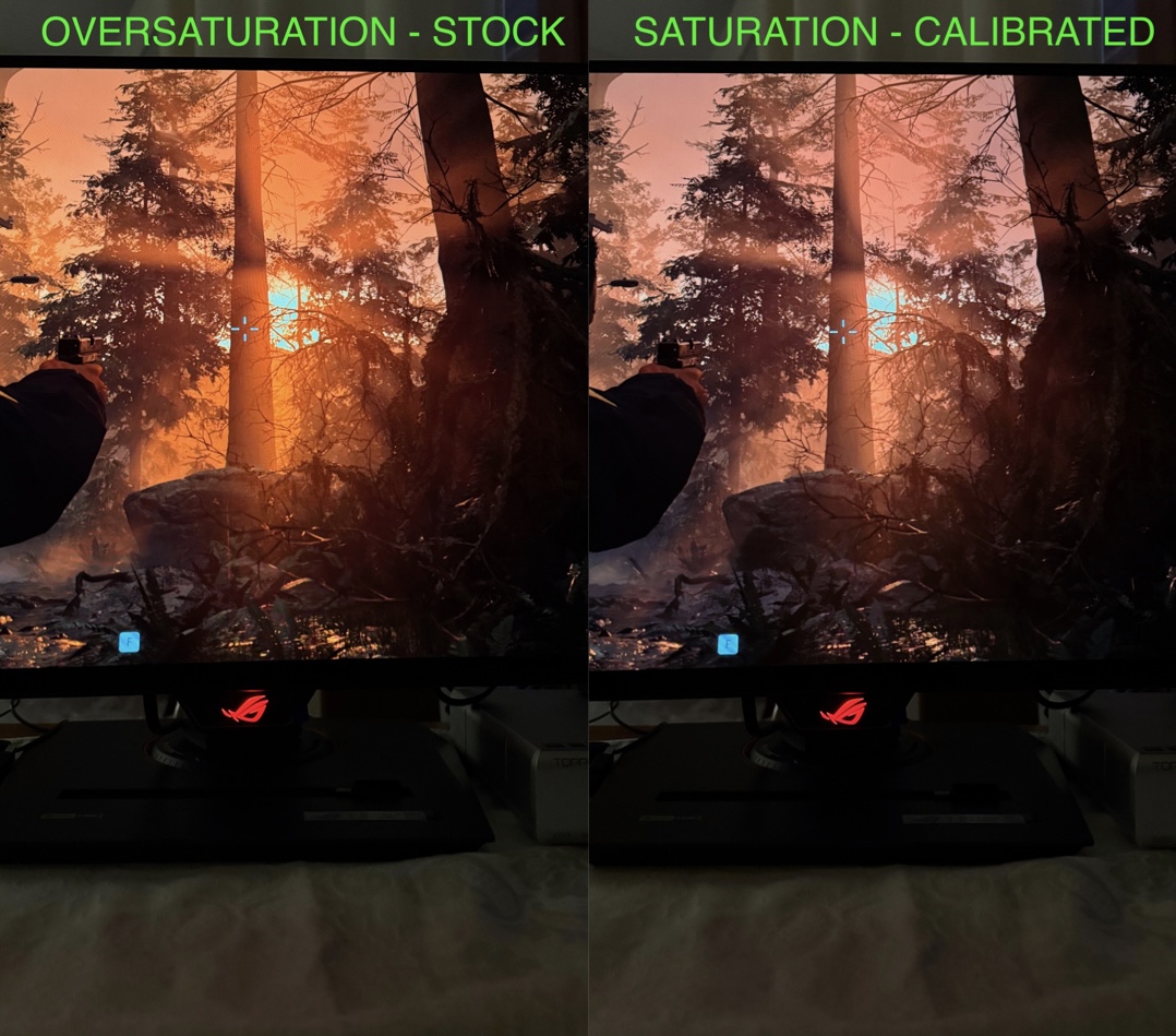

Hi, everyone, this is my fix to banding and black crush with SDR games, hope this can help
You can jump at the end of this post to see my results.

Banding
•This is the only issue I attribute to the panel itself and it cannot be fully eliminated. However, it managed to reduced it to the same levels as my good LG CX OLED TV.
•What puzzled me: my 2021 LG CX scored nearly the same in gradient tests, yet it looks far less problematic than the ASUS.
•What I found is the issue is worsened by oversaturation. Fixing this automatically reduces perceived banding to my eyes. Proper calibration and profiling and clamp to the sRGB color space using a 3DLUT in ReShade do the rest.
Black crush (100% fixable)
•Old firmware: fixed with update to firmware MCM104.
•sRGB preset: even with the new firmware, black crush occurs mostly in this preset. Using User mode reduces it.
•The panel can achieve an ideal gamma of 2.4, but factory settings make it too dark and black crushing. Again, a full fix is possible by properly calibrating and profiling the User preset with DisplayCAL and generating a 3DLUT to be used with ReShade.
