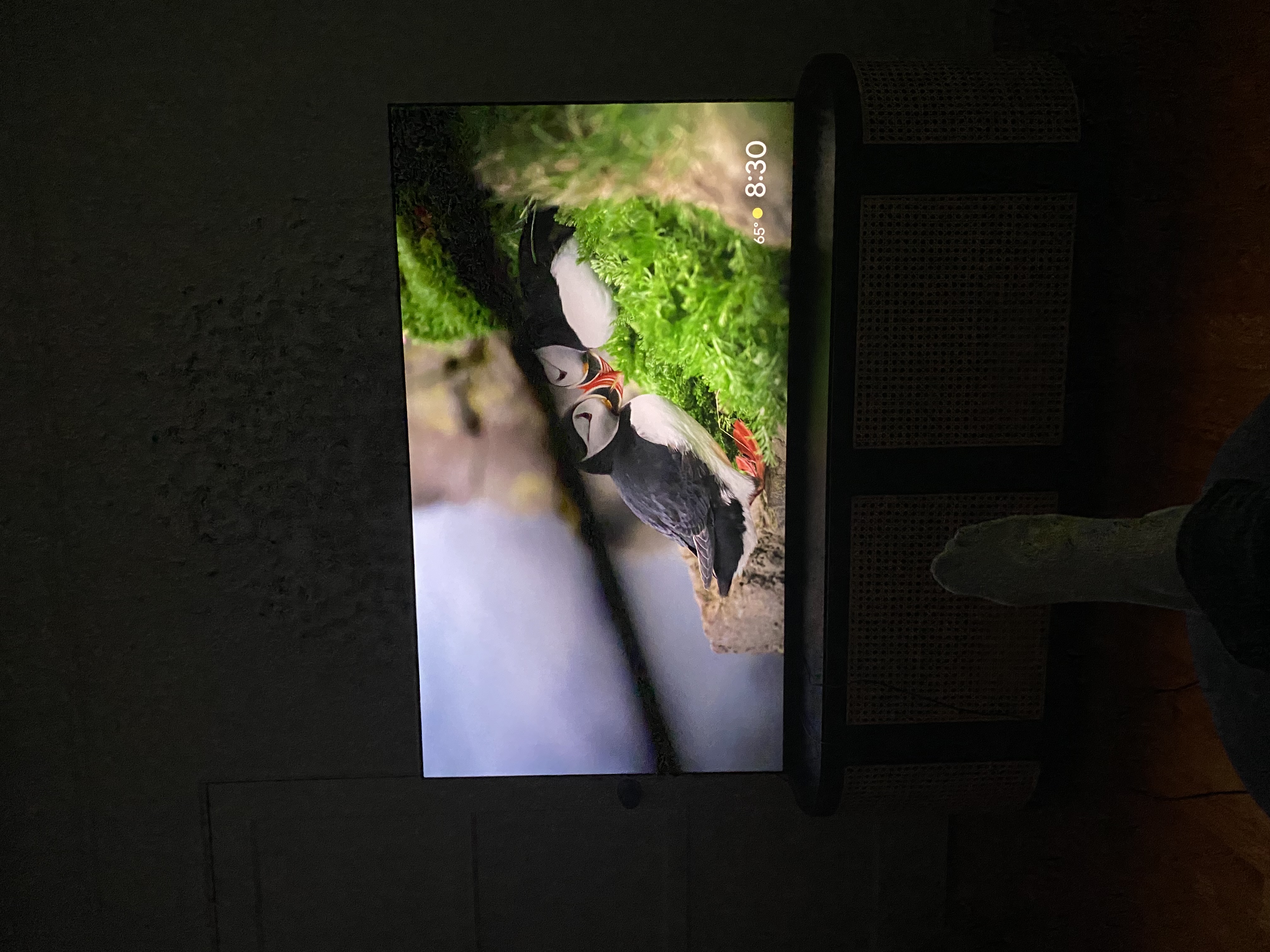

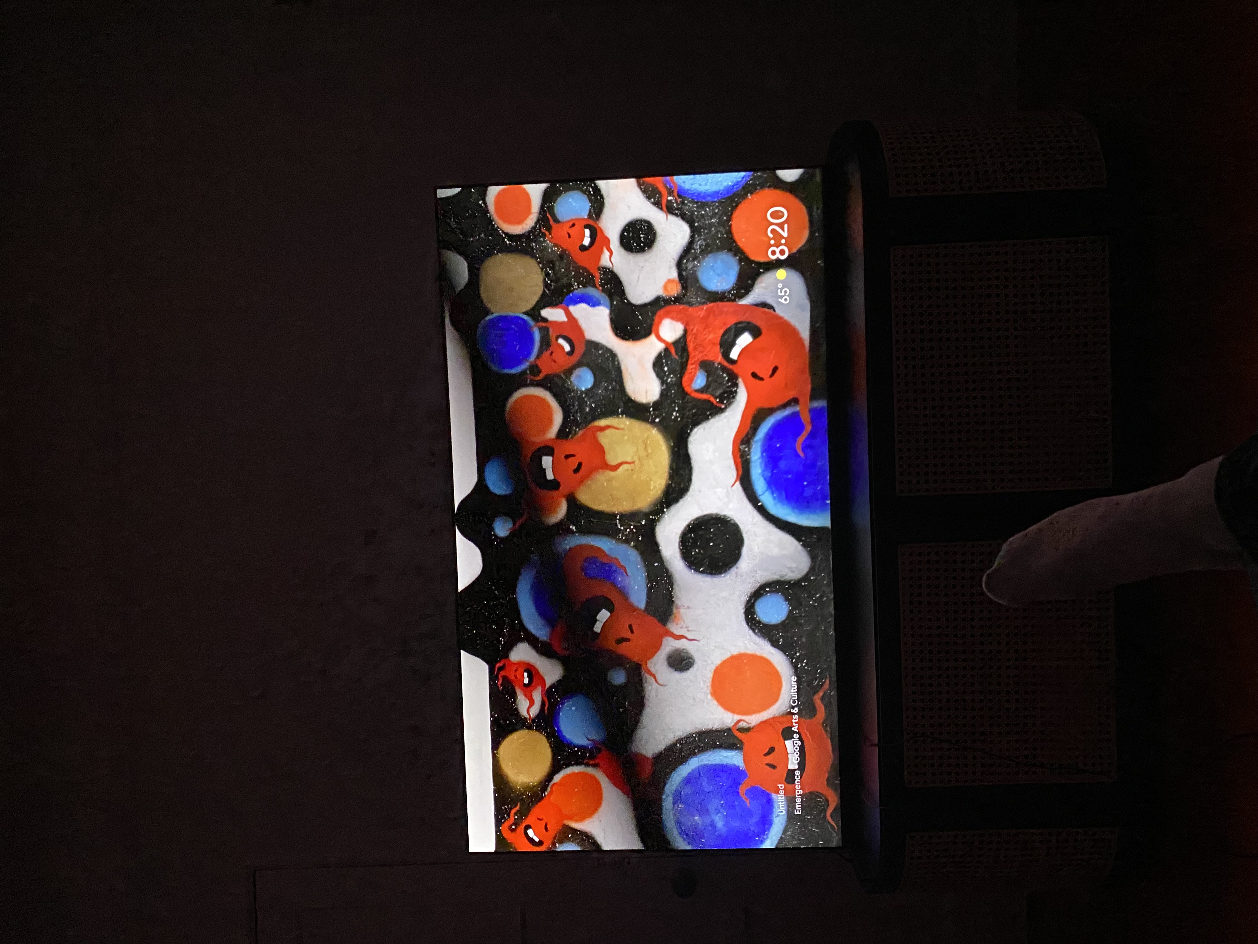

I just discovered that this set has a diagonal rolling refresh rate. Here are some pics I took with BFI enabled. This explains why it was hard to see if VRR was working with BFI enabled. Tearing would happen diagonally which is much harder for humans to spot. This is rad!
