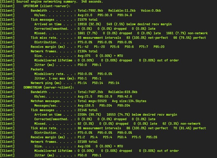

So here are my margins:
fresh installed win25h2 Pro no tweaks
9800x3d
MSI X870E Tomahawk
Lexar 6000mhz cl26 32GB DDR
MSI 4070ti
Intel T210 NIC
1300W Titanium Pro from BenQ
Aorus 360hz OLED in 24,5'' mode
Wooting 80HE
EGG OP8Kv2 2000hz 1600dpi
WD8100 SSD on PCIEX5
Cyberpower OLS1500EA-DE Double Conversion UPS (pc,monitor,router,vdsl,modem attached)
VDSL Line with 0 errors (I manually adjust the SNR and monitor the modem so I know there is no correction)
CMOS reset done and only EXPO default PBO was used and onboard NIC SOUND WIFI and BT were disabled.
since it's stock FSO,DVR,Game Mode,HAGS and all the defaults were enabled.
I am curious can you play a round on the xplay.gg retake servers, these seem to be the only servers where I can get a constantly low margin, but the servers are hosted where faceit also hosts their ESEA servers in Germany so since it's the same AS (BGP Network) I have the same exact peering and routing there but the xplay servers feel perfect but faceits don't.
I will now start to apply ReviOS and all my default tweaks install my vpn again and test some more tomorrow.

Thank you so much for sharing this!, actually you are one of the few who shared complete data, and i really appreciate you for that.
I should start to avoid responding to other users who enjoy steering the topic into another direction and come only to throw half an info then dip out...
Edit : @SammYrai can you share what is the third number after the letter bottom left corner? Ideal value should be 05 or below 07, thanks.
Anyways, i've had time to test further and i can confidently say that the most problematic metric is the upstream recv margin when this value is high the game definitely does not feel good, and this is a consistent feeling.
For the downstream margin i'm pretty confident in saying it is less impactful on the gameplay. Maybe this is what FletcherDunn meant after all, that the downstream recv should not impact negatively the gameplay.
In my case :
Game with HIGH upstream recv margin = unplayable (bullets not hitting, very slow hit reg, 300kg slow motion feeling)
Game with LOW upstream recv margin = perfect
Game with HIGH downstream recv margin = opponent have more erratic movement, but still playable
Game with LOW dowsntream recv margin = opponent movements are normal but i die faster when i get shot

Depending what happens on the server (player joining many grenades and stuff) I saw this number rise above 20. But I can test either late tonight or tomorrow again. But I think you got it wrong, the second number after the build date should be the ping / rtt.
top->bottom explained is left->right in r_show_build_info
Build date - V = matchmaking S = dedicated (community) L = local loopback
Send buffer to catch up under jitter/loss frequently delayed inputs above 15
Average send + receive latency = Ping not reflecting spikes nor buffering
Receive buffer to catch up under jitter/loss frequently out-of-sync above 05
Downstream packet loss, clamped to 9.9% frequently missing sv refresh above 10
Upstream packet loss, clamped to 9.9% frequently skipping inputs above 10
Command queue starve (too many behind) : bloat (too many ahead) often CS2'd above 0:0
Render interpolation = tickrate = 64/s (15) higher if server has performance issues
Min frametime = Max fps (1000 / 04 = 250) no decimals so actually less
Max frametime = Min fps (1000 / 12 = 83) no decimals so actually less
taken from https://www.reddit.com/r/GlobalOffensiv ... t/n23umpl/
aveyo is very knowledgeable in cs2 performance / netcode

Post by dervu » 09 Nov 2025, 06:09
Cybershoke. HSDM server with always green receive margin graph, perfect game.
Cybershoke KZ server, yellow parts intertwined with green all the time, and values in graph moving up and down, feels unplayable, every jump you feel like being moved into another position by server.

Can you tell me what's wrong here ?
My cs2 experience is very inconsistent with alot of out of order packets
