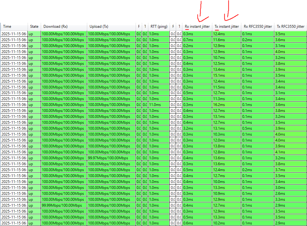

OKAY :idea:
Very important update! :
I found the culprit to my issue : upstream UDP jitter
Here is the proof :
upstream jitter capture.PNG (139.04 KiB) Viewed 5892 times
So even though my XGS-PON Fiber connection is 2Gbp/s UP and Down capable, this is only a 100mbp/s symmetrical test.
As you can see the result above the RX latency (downstream) stays under 1 ms but the TX latency (upstream) is never below 10ms and the value varies a lot which is not good. So waveform bufferbloat and most other "tools" to measure latency are not giving us the full pictures and can somehow overshadow the "raw results" of your ISP... Case closed. Now time to "fight" with my ISP wish me luck :cry:
Conclusion :idea: : i found the culprit to the low in height yellow lines in the CS margin graph after months of research and testing, Valve network engineer and other ppl on twitter and reddit that consider themselves "expert" on the matter were not able to give me a conclusive answer.
well good news if you have the same issue as me (too much yellow lines low in height in cs margin graph) even tho you have no packet loss or bad network values, well the issue is :arrow: upstream UDP jitter as shown in my screenshot above.
