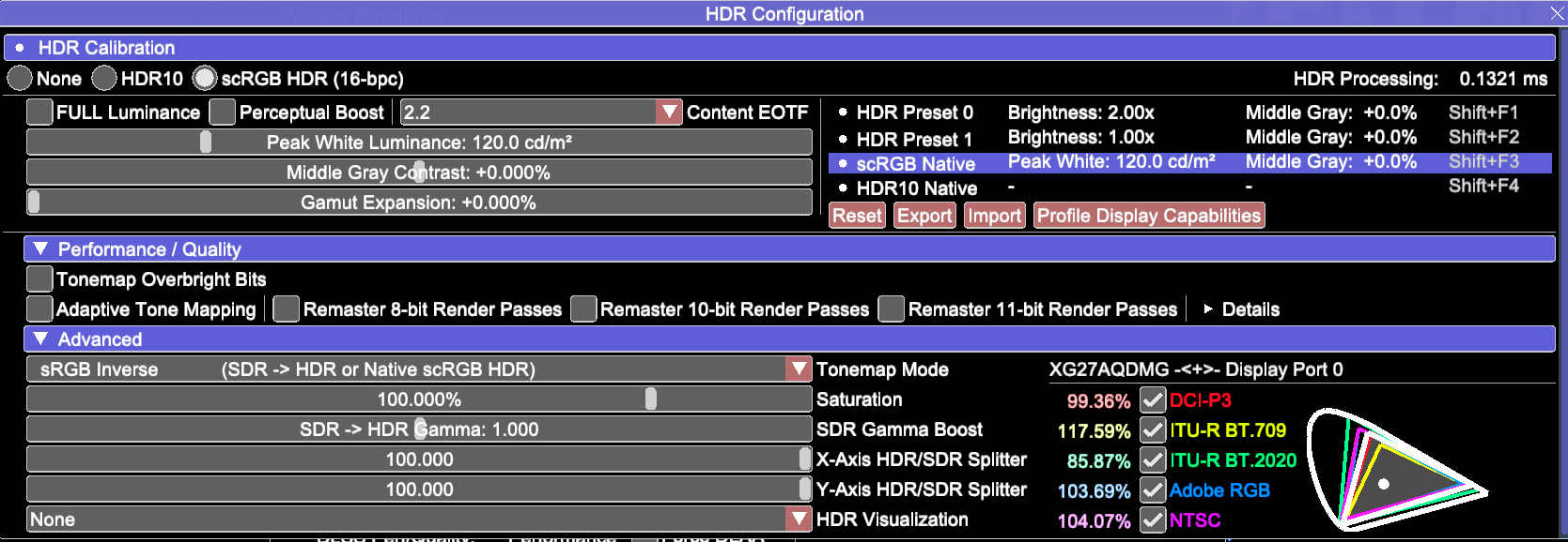

A workaround right now is to run SDR games in HDR, and fix the gamma using SpecialK using these settings:
Click the "Reset" button first to reset all processing, and select "SDR->HDR or Native" in "Tonemap Mode". This should result in plain SDR looking as intended. The "Peak White Luminance" slider in this setup acts as a general brightness slider. The most important setting here is to use "2.2" in the "Content EOTF" setting. This uses 2.2 gamma which is what the vast majority of SDR games use.
