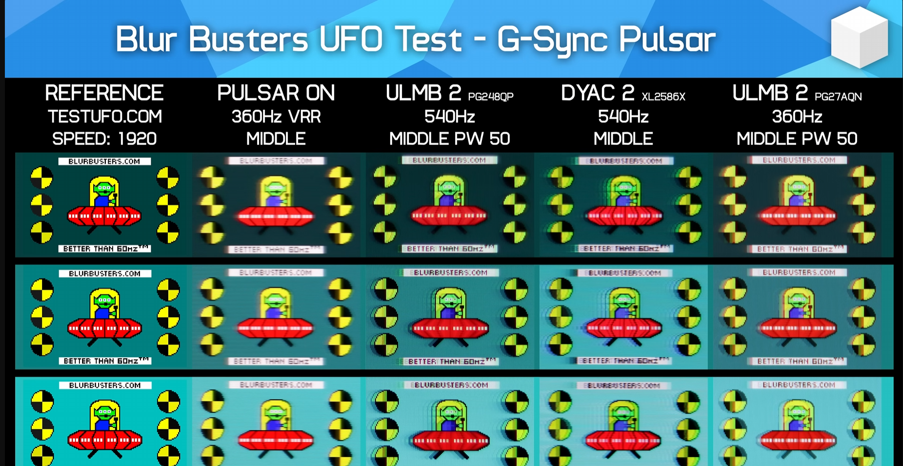

Is it just me or does pulsar motion blur reduction seem weaker than ulmb2 when getting closer to maximum monitor refresh rate? At the top or middle of the screen at least, it seems to outperform ulmb2 at the bottom regardless. I haven't seen any reviews mention input lag either.
