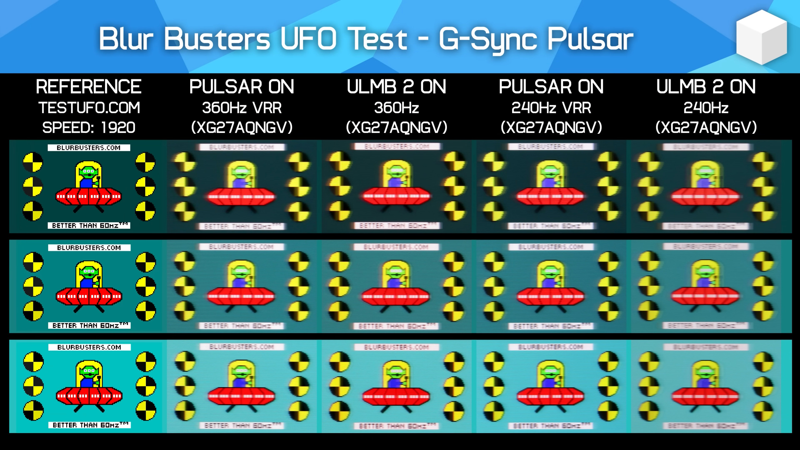

Discorz
VIP Member
Posts: 1151
Joined: 06 Sep 2019, 02:39
Location: Europe, Croatia
Post by Discorz » 12 Jan 2026, 17:29
liquidshadowfox wrote:
10 Jan 2026, 22:28
Discorz wrote:
10 Jan 2026, 13:23
So if I'm thinking right ULMB (without g-sync) on these monitors won't have as much artifacts. Anyone tried it?
I agree with the above and ULMB without Gsync enabled looks a little clearer than gsync pulsar to my eye, not sure if they disabled the secondary pulse but it does look a little clearer. It just really sucks I can't enable ULMB2 on my pg27aqn AND keep gsync pulsar on my new display to compare.
Damn, I missed new ULMB 2 shots from MUB. For some reason they appear to be using the compensation pulse for standard ULMB 2 as well. It's either that or speeds on some of these shots are not 1920 px/sec.
MUB Pulsar vs ULMB 2026 UFOs.jpg (857.02 KiB) Viewed 4945 times
Also why not call it ULMB 3? It differs more from ULMB 2 than ULMB 2 did from ULMB 1 anyways.
