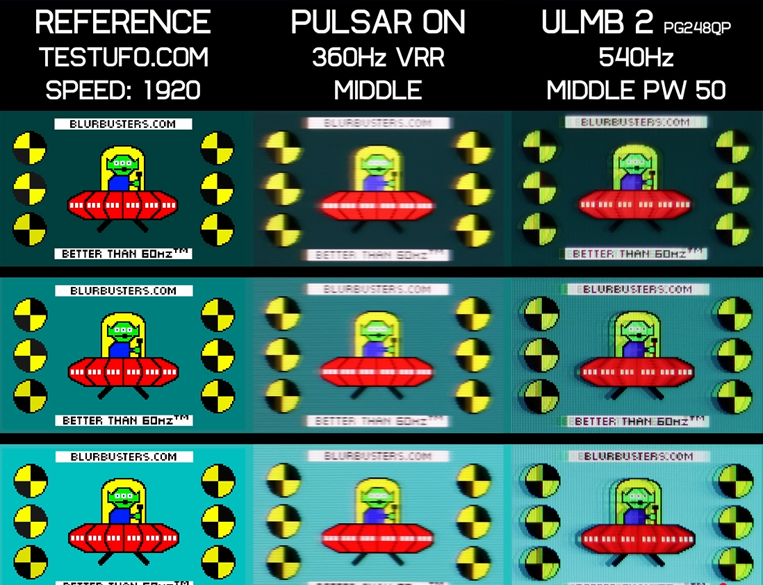

they dont even seem to be in the same clarity realm, if you are a no crosstalk enjoyer who plays only aim trainers on static single colored grey and cyan backgrounds, you are gonna love this monitor
- yyy.PNG (1.28 MiB) Viewed 5435 times
