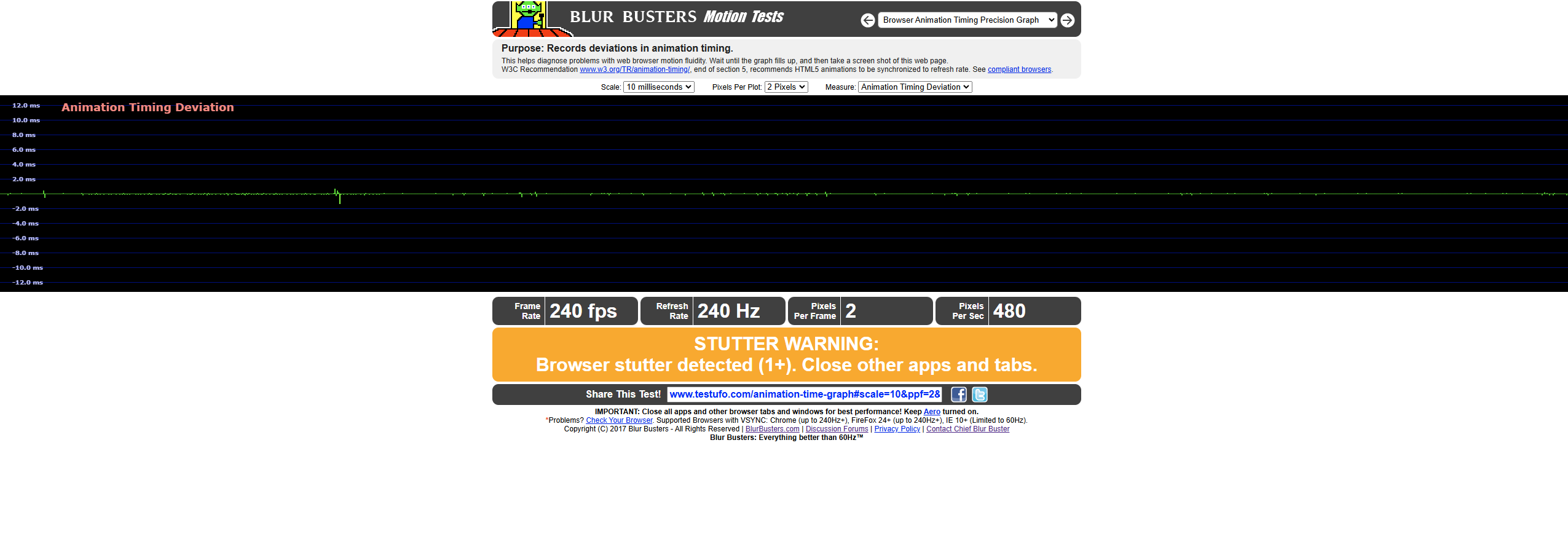

I am running into issues with the Animation Timing deviation test on testUFO. When the graph is not in fullscreen, there are little to no spikes present. (below)

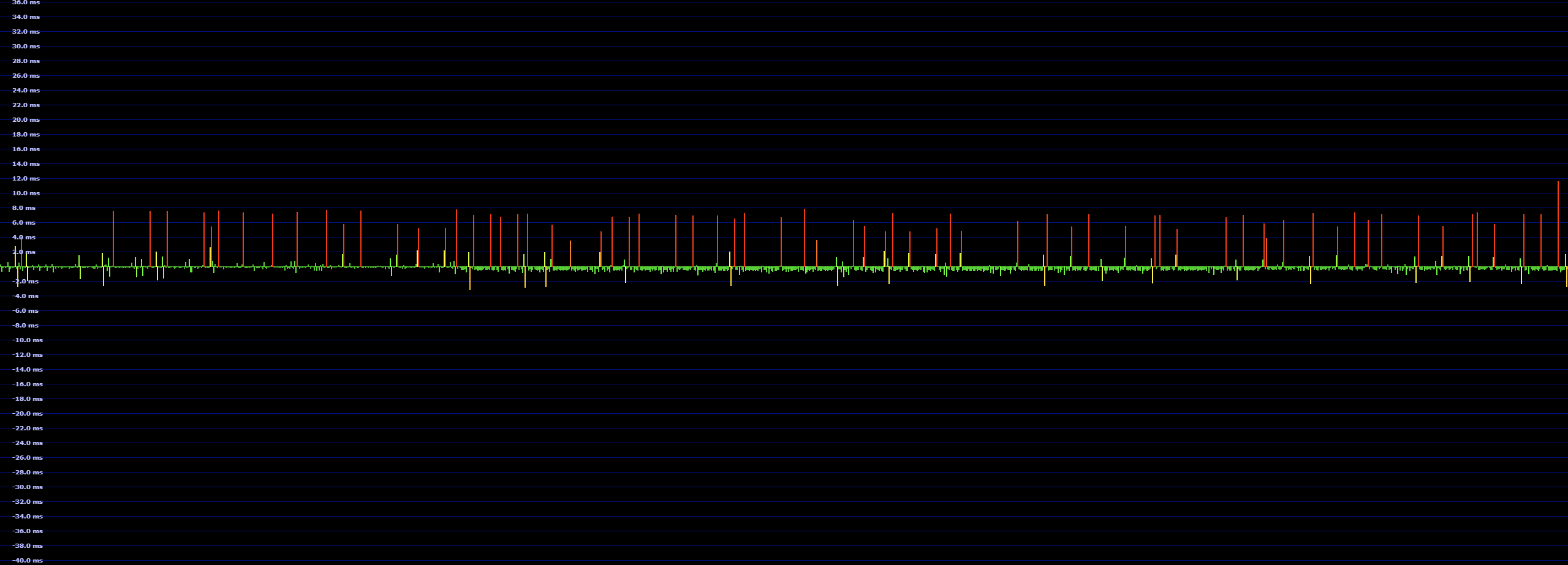

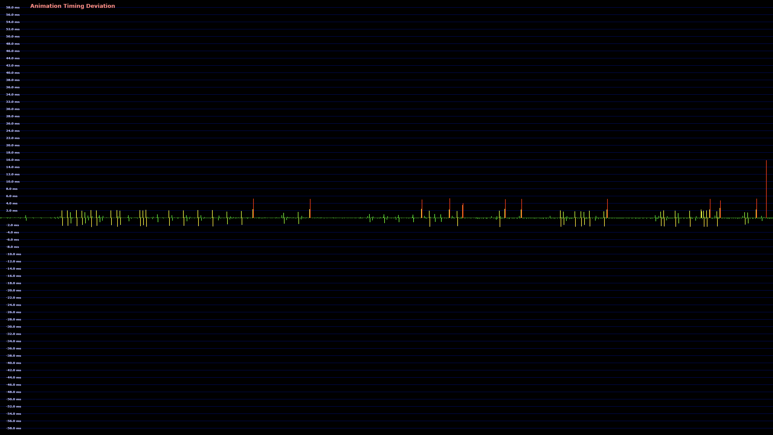

Then, when fullscreen, the graph has repetitive, cyclical spikes.
Sometimes, these spikes get more severe, but only when in fullscreen on the graph.
