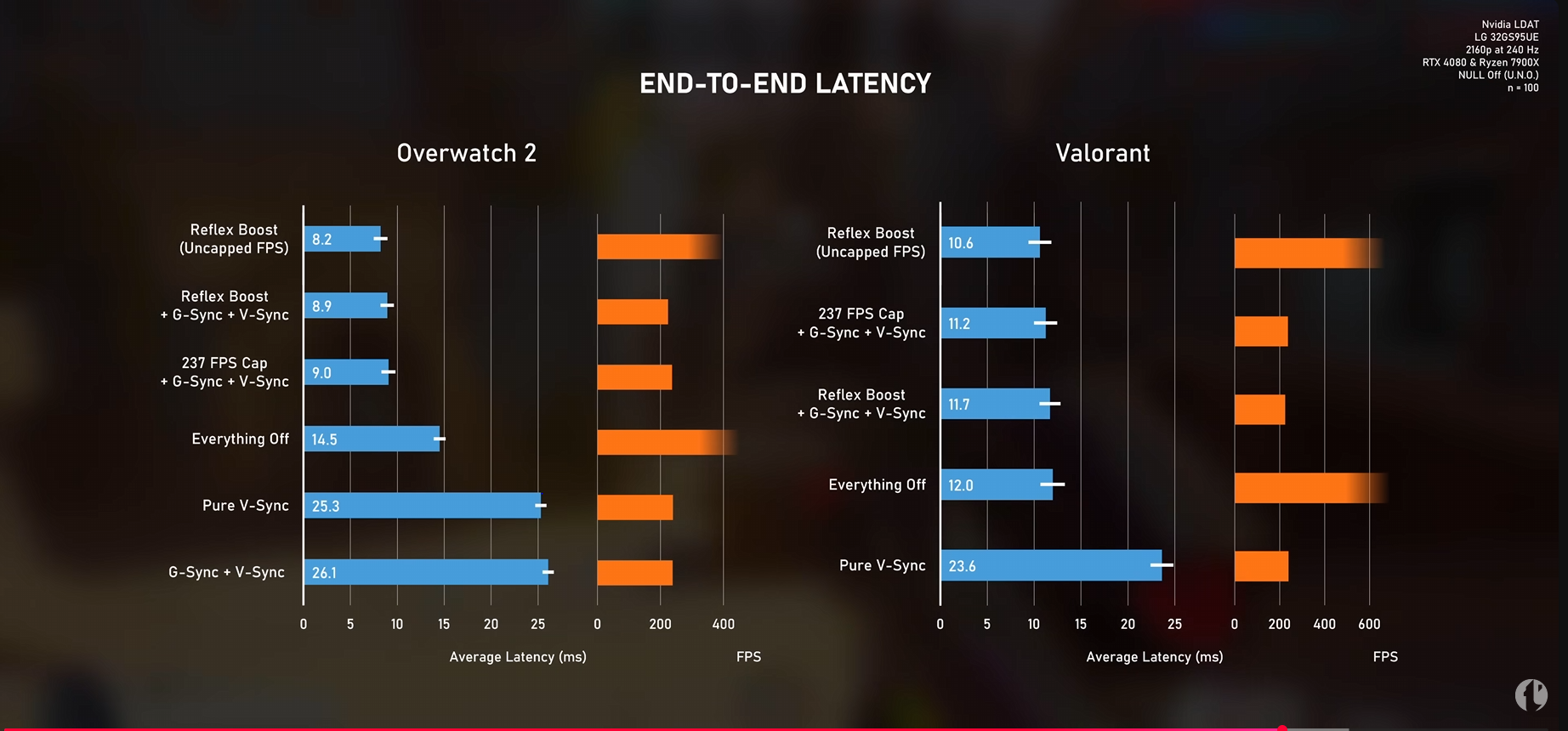

The question is, does this scenario ( vsync + gsync + reflex) result in increased latency as opposed to totally uncapped frames + reflex? The answer is yes it does, very slightly. We're talking 1ms or less difference though.

You can test that yourself in a game like cs2.
Funnily enough, CS2 performs better when you do GSYNC+VSYNC+Reflex (encapsulating your general frametime). :)
I believe you need to distinguish the 'tearing' portion of fixed refresh rate from actual lower total system latency.

My friend I have to say it is you who seems to not be fully aware of what you are looking at. The screenshot you posted compares manual frame limiting vs vrr. In that scenario and when comparing the two G-Sync does not add any latency. The scenario we are discussing is weather fully uncapped frames with Reflex enabled in a game that can reach 600fps plus results in lower latency compared to GSYNC+VSYNC+Reflex. I'm only talking about pure latency readings not making an argument about which is objectively "better".
The point of the screenshot is that the technology itself does not add additional processing latency in the total system latency chain.
If your claim was true, you'd see a increase in total display latency regardless of frame rate limiter.
Get a 610Hz TN and such frametime (present-to-present time) discrepancies aren't an issue.
That's what I originally wrote in the first place a few posts back.

Uncapped frames + Reflex is still king for latency in high fps games even if the difference becomes marginal at higher refresh rates. You don't have to believe me but it's what tests like this suggest. Regardless I don't think its that important when the difference is so small. I'm really wondering how Pulsar stacks up to ULMB2 though at lower refresh rates (75–200Hz). There should be a big improvement in theory but it seems to have some issues. Getting the XG27AQNGV tomorrow to test.
Perfect example of how impactful Nv Reflex is at keeping the render queue depth to ~1 & eliminating GPU congestion-related system latency increases :)
The test is, sadly, misleading by techless :)
FYI — 75–200Hz range gives you “effective 300–800Hz motion clarity“... which is a extremely underwhelming target.
