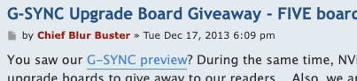

See "2013" in this screenshot:
Screenshot 2026-02-26 at 4.29.46 AM.png (22.12 KiB) Viewed 4190 times
Back in 2013, I created Blur Busters Forums specifically for the GSYNC giveaway. This forum was originally created because NVIDIA gave me 5 GSYNC boards to give away to the public.
We were the world's first website to measure the input lag of GSYNC in January 2014, you remember. Nobody else measured input lag of GSYNC before us. We were the first.
