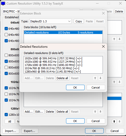

I've tried CRU to create a custom res for 1080p at 599.91 but won't display the resolution even at different EDID settings so I'm kinda stumped here.

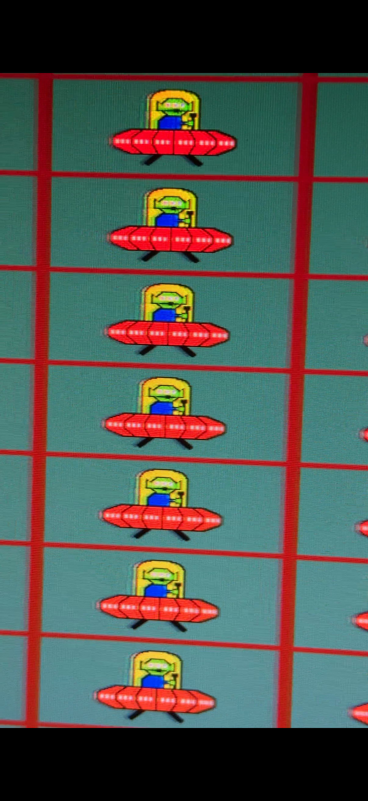

Below are stills from the crosstalk test video I took just now and the images below consistently represent top/center/bottom characteristics as I have Dyac 2 turned on (High or Premium has no effect):
-1290x960 at 599.91hz
No problems here
-1920x1080 at 599.94hz
Note the black outline of the previous' frame alien head cutting into the eyeball of the current frame alien here ^ :(
I've tried to align crosstalk with the 2.0.9 utlilty but it didnt seem to have any effect on this monitor. Even trying random values in softMCCS had no effect either.

I can only find 599.91hz at the lower 1280x960 resolution. Any attempts to get 1080p to take 599.91 in CRU, whether in Display 1.3 or 2.0, results in it only allowing for 599.94hz
Screenshot 2026-03-12 024104.png (62.11 KiB) Viewed 12058 times

Try playing around with the Front/Back Porch, Blanking.
Perhaps fixing the refresh rate to 599.91 in CRU would help? But I don't think the actual value is what drivers the lower crosstalk behavior

For non-pursuit photos of strobe backlights, did you keep shutter speed faster than refresh cycle?
E.g. 1/600sec or faster for 600Hz?
Otherwise, it captures additional duplicate images from exposing multiple refresh cycles -- instead of just strobe crosstalk
If you prefer a slower shutter speed, you MUST pursuit the camera (pursuit camera). However, for strobe crosstalk analysis, static photography is easier, but the shutter speed has to be fast enough to capture only one strobe flash.

I took a pursuit video until it looked exactly how it looked irl and took the stills from there. I figured it out just now for a stupid reason despite all the complaining. Basically, followed what witega wrote @ viewtopic.php?t=14300 about using "Exact Reduced" timings and I was finally able to set my refresh rate to whatever and resolved the issue I was seeing. :lol:
