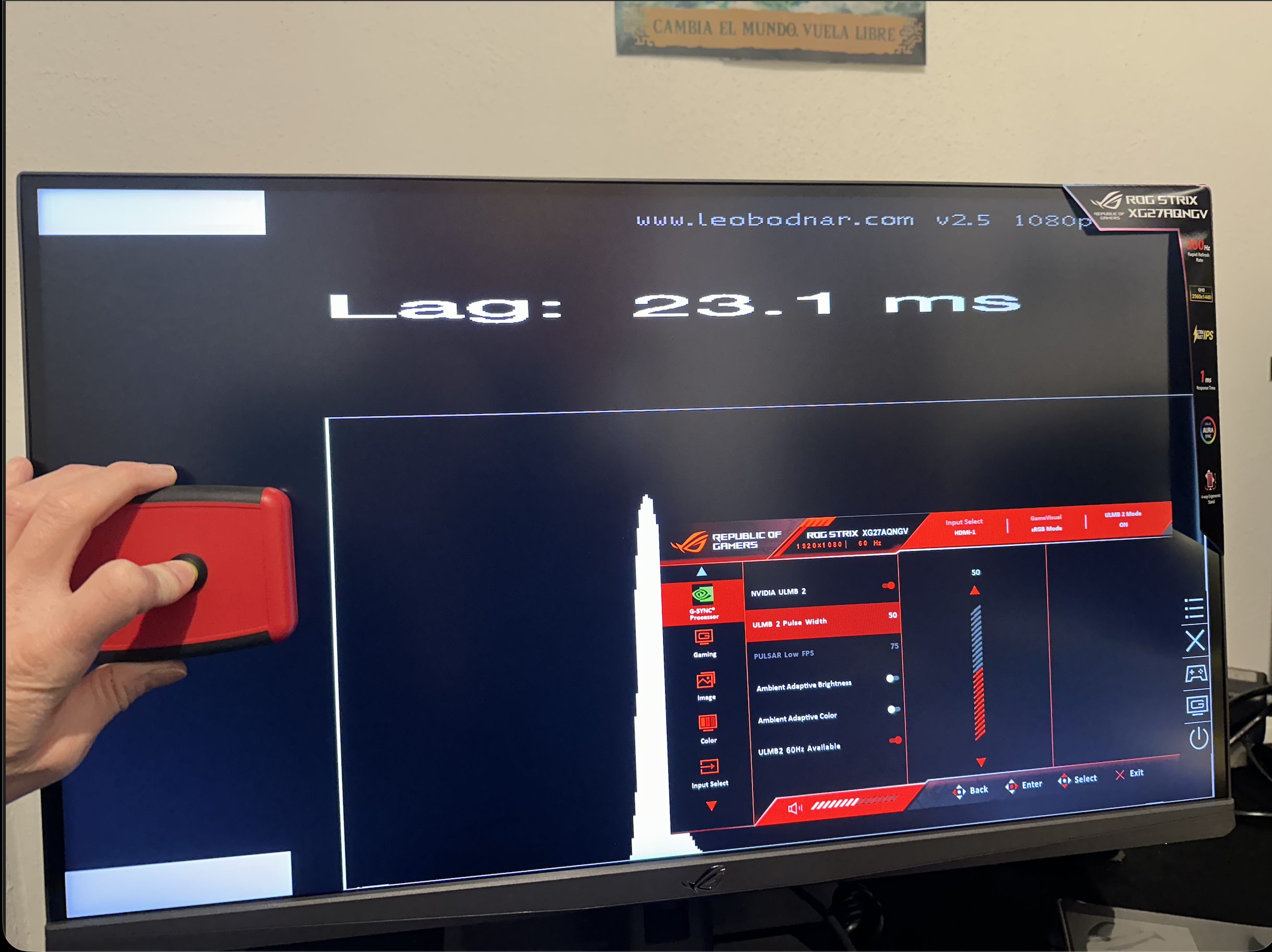

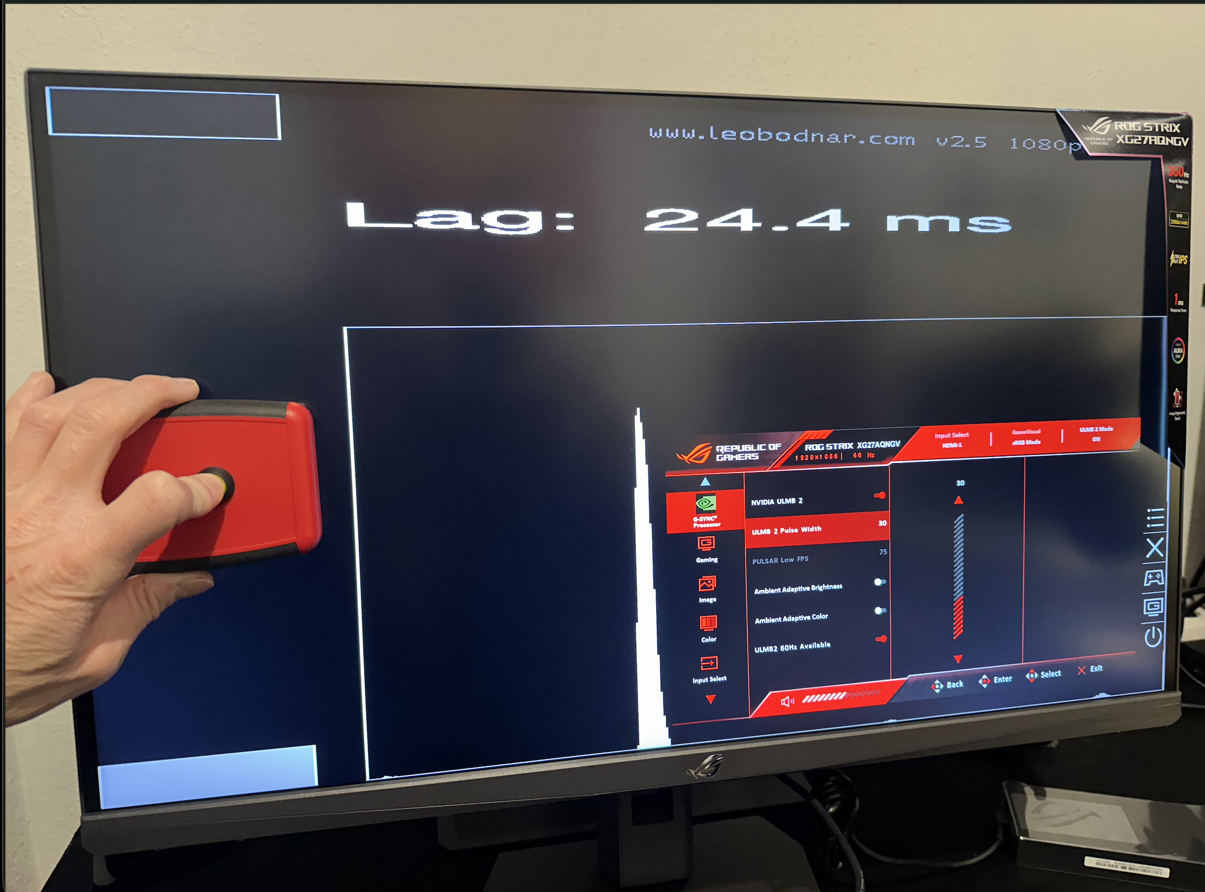

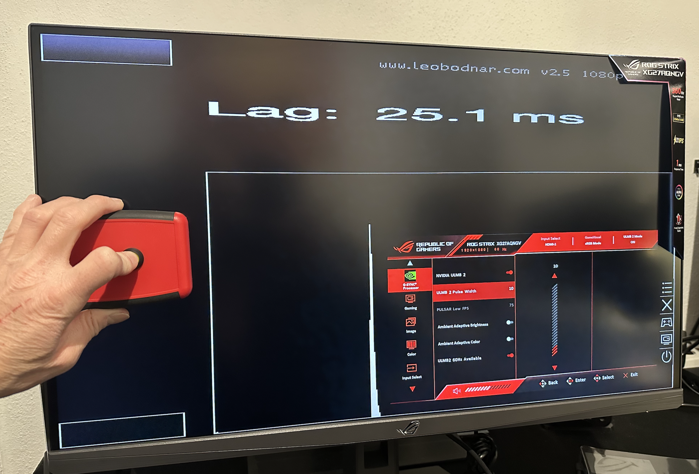

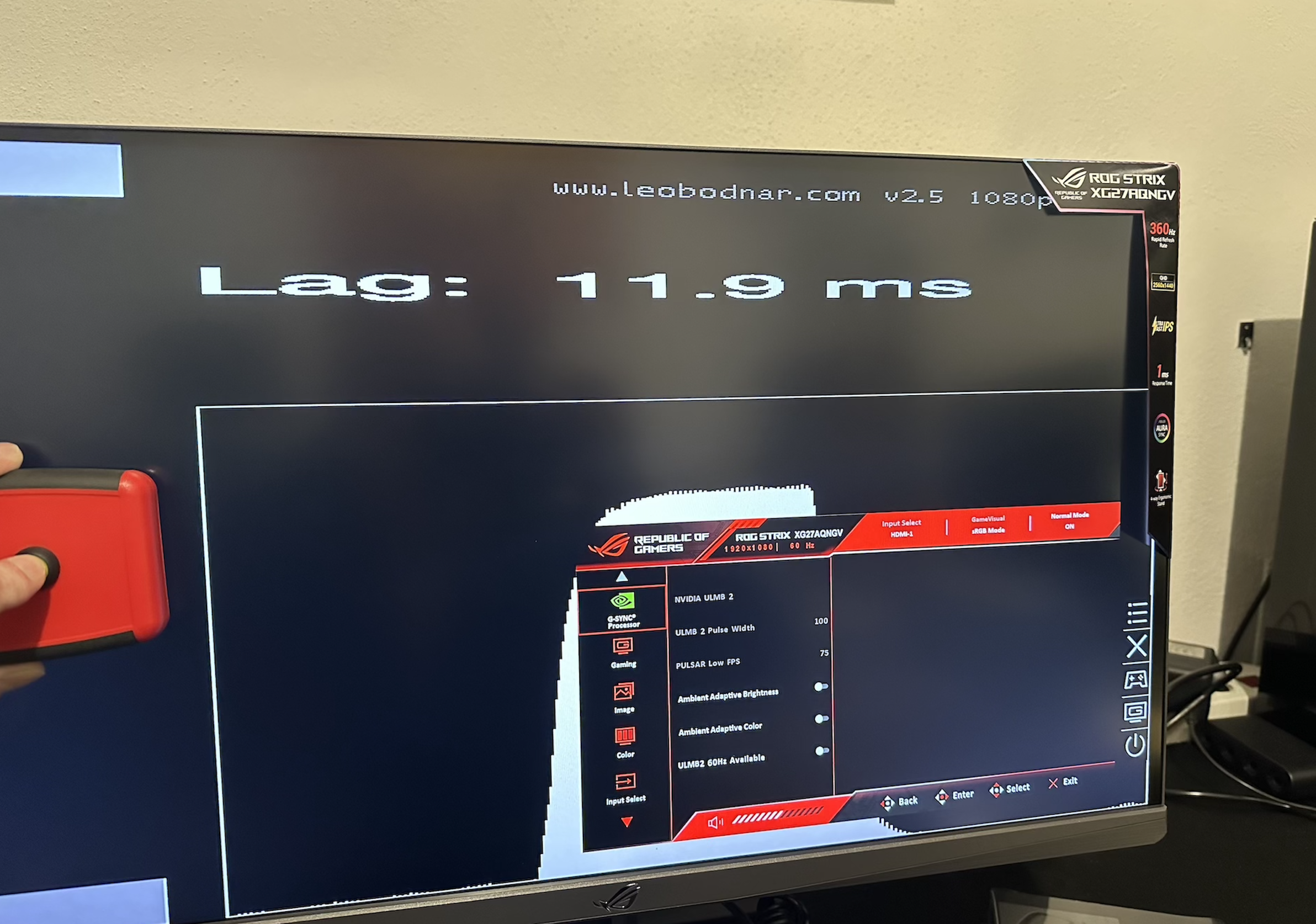

Here I am sending the different photos you asked for:
* one with **ULMB disabled**, where as you can see the result is **11.9 ms**
* and then the measurements with **ULMB at 10, 30, 50, and 100**, so the full range can be seen
That way, I think it helps show quite clearly, as you rightly said, what the strobing is adding.
Regarding the **flicker**, it is true that it does not bother me personally at all. I have been used to CRTs all my life, so it feels completely natural to me. If I had to say which one seems to flicker less, I would actually say the **ASUS**, even though it is a **27-inch screen** and the XG is only **24 inches**. In fact, I think there were moments when I noticed the flicker more on the **XG**. Again, flicker does not bother me in either case, but if I had to choose, I would say the ASUS seems slightly better in that respect.
As for the **24 ms of input lag**, I want to be fair: that is not a high number in absolute terms, and I am sure many people would find it perfectly fine and enjoy the monitor without any issue. I know I am especially obsessive about these things. I am very sensitive to motion blur and input lag, so I judge these displays from a very demanding point of view.
Still, when playing more demanding genres — especially **fighting games, shoot’em ups, or platformers with very tight jumps** — I do personally notice that extra lag, especially in **fighting games**.
That said, if I had to recommend this monitor to someone looking for **motion clarity at 60 Hz**, I would absolutely say it is **wonderful**. For console use, it is basically like the **XG**, but with **virtually no crosstalk** and much higher brightness.
As for the **XG on PC**, when using **Quick Frame Transport** and **CRU**, it is truly amazing. In that scenario, to me, it is basically perfect. Yes, it has lower brightness, but that does not really matter to me because I play in an almost completely dark room with no window — what I call “the Dungeon.”
So overall, yes, I would definitely recommend this monitor. I also agree a lot with **John Linneman from Digital Foundry** when he said how incredible it is to see an LCD with this kind of brightness and this level of motion smoothness. In that sense, it really is something special.
If this monitor had **16 ms instead of 24 ms**, I honestly think it would be **almost perfect**, and I would absolutely be willing to pay **3,000 euros** for it.
I hope my measurements and impressions have been helpful.

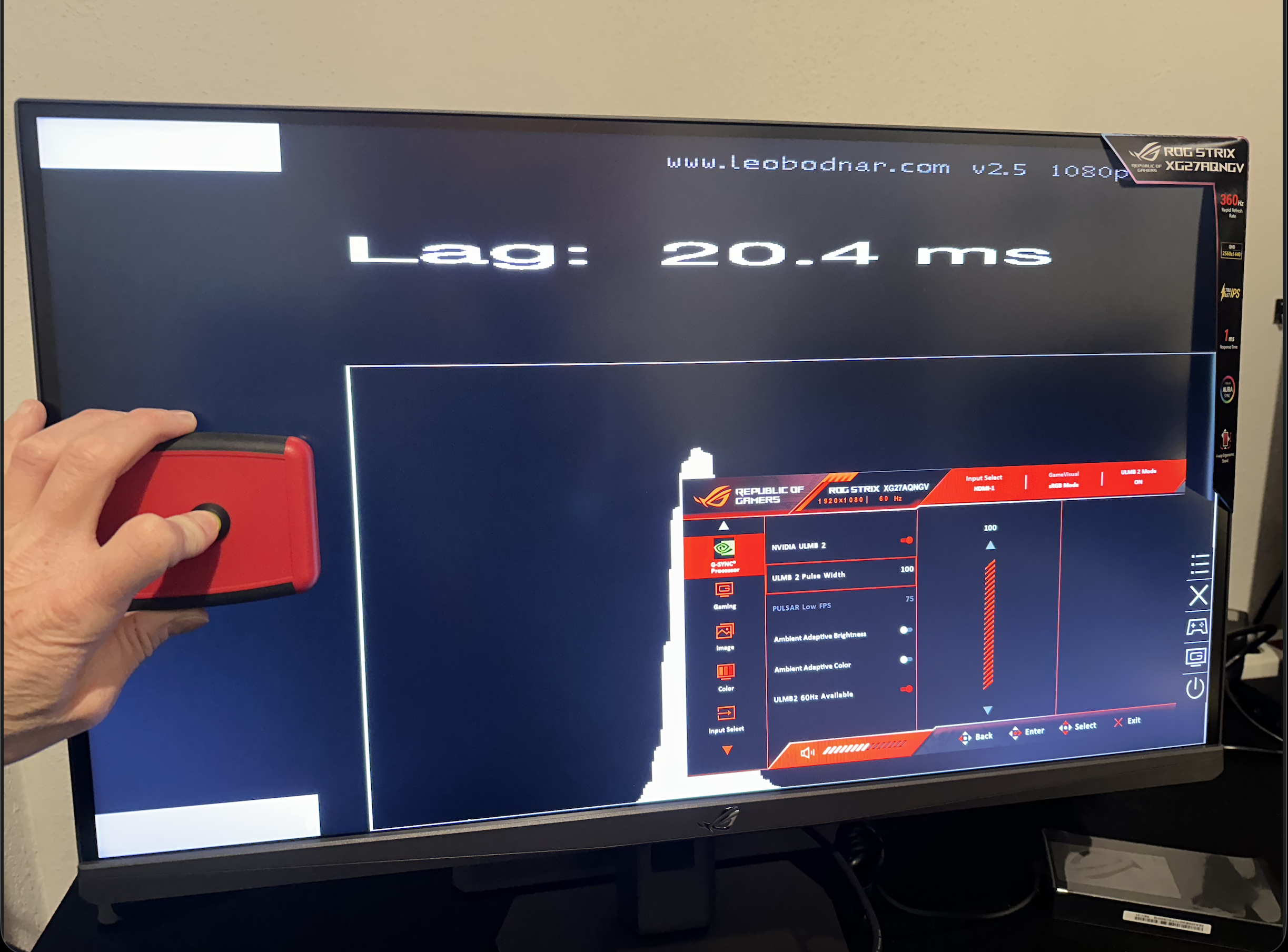

As for the **XG on PC**, when using **Quick Frame Transport** and **CRU**, it is truly amazing. In that scenario, to me, it is basically perfect. Yes, it has lower brightness, but that does not really matter to me because I play in an almost completely dark room with no window — what I call “the cave.”

What is interesting is that I also have another monitor, the XL2411P, and when comparing the three monitors, you can really see how differently strobing behaves depending on the technology used.
On the XL2411P, without DyAc enabled, I get around 10 ms in the center of the screen, and with DyAc enabled it goes up to about 15 ms. So in that case, strobing is only adding around 5 ms.
On the ViewSonic XG, without PureXP enabled, I get around 8.5–8.6 ms, and when I enable PureXP it goes up to 16.4 ms. So there, the increase is about 7.9–8 ms.
On the Pulsar, I get around 11.9 ms with ULMB disabled, and then about 25.1 ms with ULMB enabled. So in that case we are talking about an increase of roughly 13 ms.
So based on these numbers, what we have is basically this:
• DyAc adds about 5 ms
• PureXP adds about 8 ms
• ULMB adds about 13 ms
At least based on the measurements I have, that is what the data seems to show.
