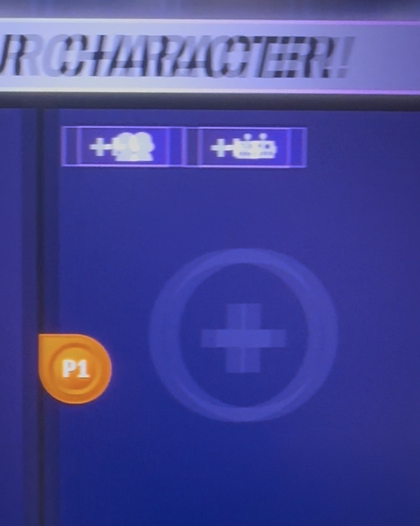

It's very difficult to properly take a pursuit photo in a game without a sync track, but I'll take a stab at capturing what I see.
My game of choice is Rivals of Aether 2. There is eyetracked motion situations all over the game (Plus separate menu and ingame frame limiters adjustable to the frame cause the devs are goated
) The menu is running at 90fps here. The orange P1 cursor takes ~1.2s to move across the screen (stopwatch by hand, not perfect) so that would be about 2560/1.2 or ~2133px/sec motion. The background is a dark-ish purple so this should be a bad case scenario but it is clean. On occasion a random frame being slightly late makes the compensation pulse double image faintly come in but it goes away quick. Even plugging in another controller allows you to purposely trigger a large stutter that will make Pulsar completely disengage then come back with compensation pulses. Still it goes right back to looking how it does in the photo within a second or two.
I can definitely say I've observed that in a match, where framerate naturally is less consistent than a menu, the preceeding image is a little more noticeable but hardly anywhere near 1/2fps of hz on a CRT look. It's way less noticeable than the strobe crosstalk outside of the sweetspot zones on the Dyac monitors at my local tournaments. There are constantly situations in Rivals2 where you are trying to eyetrack motion at the top and bottom of the screen and the crosstalk there is bad enough that you might as well not even be strobing. (Mind you these monitors are not BB utility tuned, and I don't know which Zowie monitors they are. I just know they are older monitors [iirc 144 and 165hz models?] and definitely NOT the newest flagship ones. I'll double check when I'm at the venue again.)
