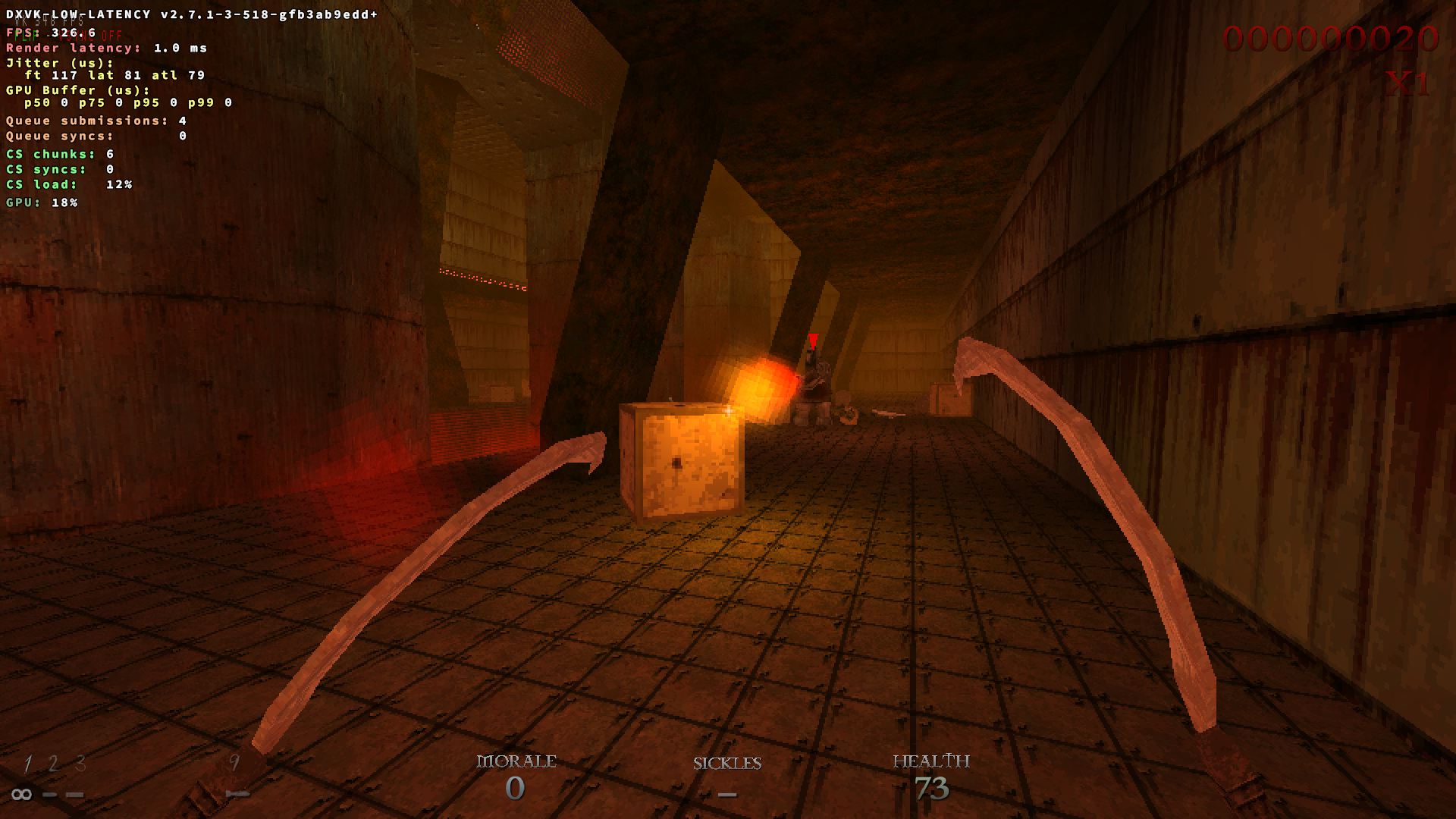

Seems you never tried dxvk-low-latency, some games run so good with this that you have never experienced any other platform, especially concerning the VRR capabilities. So d3d8-d3d11 is fully covered, the only thing missing on Linux is great frame pacing on d3d12.

I don't know why you would ever want to use V-sync with fixed refresh like that, but of course you can just use a great limiter with VRR, or if you don't have VRR, just use tearing:
DXVK_FRAME_RATE=120 DXVK_FRAME_PACE=low-latency-vrr-360
There are plenty of people reporting issues with MangoHud frame limiting, I'm not the only one:
https://github.com/doitsujin/dxvk/issues/5340
(and yes, I keep the DXVK_FRAME_RATE variable in dxvk-low-latency)

Then you are unlucky, VRR is something I wouldn't want to miss out on. Lots of people use my VRR mode with OLED monitors, but occasionally I get reports that their setup flickers - so this is then an hardware issue.
DXVK supports the mode you're using though too, but don't expect to get good input lag with it:
dxgi.syncInterval = 3 ... 4, etc.
https://github.com/doitsujin/dxvk/blob/ ... .conf#L214

Well, I can implement that if more people would request that. But it wouldn't be low-latency then, cause in order to not miss v-blanks you have to have a sizable buffer.
RealNC wrote: ↑
24 Apr 2026, 07:57
I don't know. With VRR, even retroarch looks perfectly smooth to me. And the low-latency VRR limiters (Special K's "low latency" limiter or the Nvidia limiter) are not accurate, they have like +/- 0.3ms jitter or so, but it doesn't affect smoothness when in VRR mode.
The only case where VRR isn't smooth is when the game stutters (which of course isn't something that VRR can fix.)
Afaik retroarch should be doing the fps limiting, so there is not much to do from the VRR side, especially if retroarch just pushes out 30/60 fps?!
You can have well below 0.1 ms jitter with my pacing, at which point it gets super smooth. Of course you can even go lower and smoothness will further improve to previously unknown territory, but things like turning off SMT, enabling a gaming scheduler, etc. matters a lot then, because low latency pacing relies on predictability.
And yes, compare normal dxvk with dxvk-low-latency in Overwatch for example, there is just no contest in smoothness. So for you normal dxvk might already be smooth, but to me it was laggy and video playback speed wobbles back and forth. This is why I've put more than half a year of full time work into this and it finally payed off.
