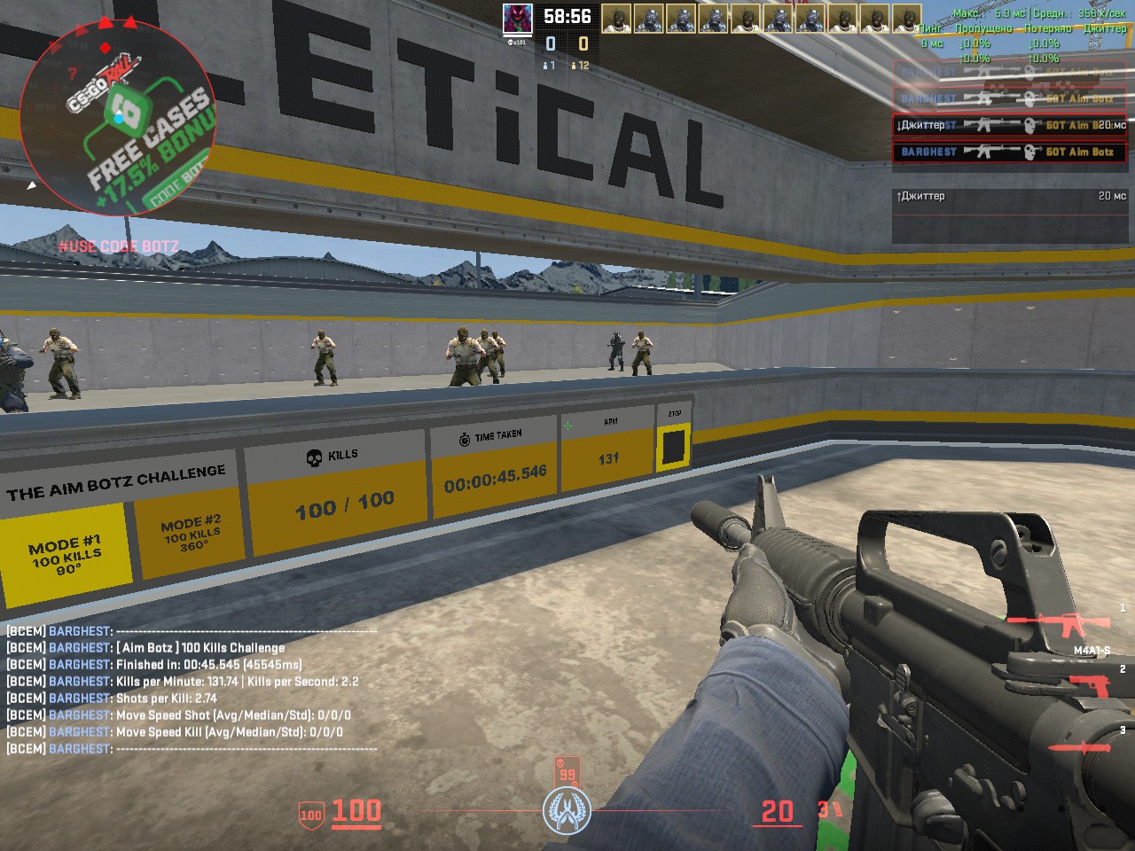

I did everything exactly as the author described, but while I did notice a change in the mouse, I haven't seen any “wow” effect. I don't know, maybe the cat's butt got in the way while I was typing. If it actually worked, I think I could have done it in 36 seconds even if three cats were in my way. As you can see in the screenshot, the longer time is after I made the adjustments... alas, it's even.
Translated with DeepL.com (free version)

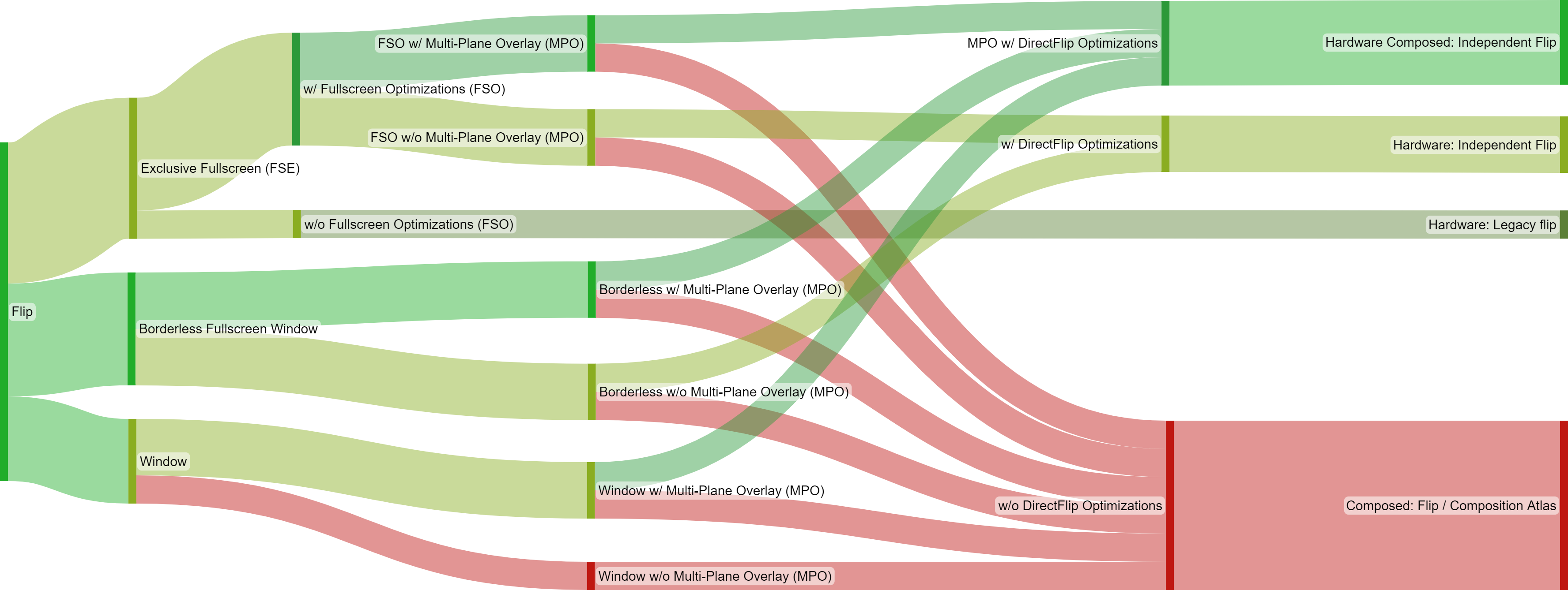

disabling mpo adds input lag by making the game in composed flip i recommand after doing my own testing on 3 different systems to keep it enabled for hardware independent flip presentation mode
SammYrai
Posts: 20
Joined: 28 Jul 2024, 15:30
Re: FIX floaty and sluggish mouse feeling
Post by SammYrai » 23 Apr 2026, 11:55
Correct, on win11 with a modern GPU and drivers you never want to disable MPO anymore if you run FSE. If you really think MPO is your culprit, then disable Full screen optimizations for said game and you will bypass MPO and can test for yourself.
Edit: One exception is FSO on without MPO. But This doesn't work on every game since you need directFlip Optimizations. If you really want to run this you also need to check with presentmon, as for a long time it didn't work with custom resolutions in cs2 but it did in Valo and once I noticed this it explained why my valo was running way better then cs2
On windowed and borderless you you will also always end up in composed flip with MPO disabled. That doesn't automatically mean you won't run in composed flip if you have MPO enabled. To prevent that you need to achieve directflip.
Directflip works if your game runs at native or / covers your whole screen (there are some exceptions) which is why I highly recommned to test with presentmon (preferably cli in background) which flip model you are using with your game in windowed or borderless.
You never want composed FLIP as it will always go trough DWM
