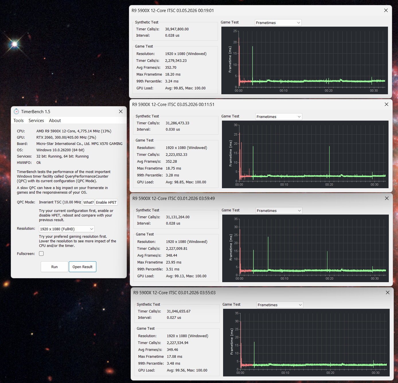

Edit 2: I recently discovered that cppc enabled & cppc preferred disabled is the ideal bios setting for my AMD dual ccd 5900x. It's specifically for dual ccd's. Can also be advantageous for other cpu types. Main gain here is cppc preferred causes windows scheduler to favor and assign processes to the 2 best cores. This causes those 2 cores to get overloaded and suffer constant context switching. This can also cause processes to jump cores a lot because they are constantly competing to use the 2 best cores. This causes processes to migrate to the other ccd requiring recaching memory to the new ccd. CPPC prefered disabled prevents this by utilizing all cores not favoring any core. Resulting in less context switching, overloading, ccd migration and competition for cpu time. It also reduces hotspots since the workload is spread across all cores rather than the 2 best cores. Which in turn minimizes constant fan ramping. As when the load is only focused on 2 best cores, the heat spread is lessened resulting in constant fan ramping to dissipate that hotspot. It's easier to dissipate heat when it's spread out rather than being localized to 2 distinct areas.
It also solved my periodic frame jitter problem. Using the blur busters mouse test https://testufo.com/mouserate . I used to get consistent large gaps in my mouse reports. This fixed that jitter for me. I'm really happy I finally figured that out. It was the last and only performance problem I had with my machine that I gave up on for the longest time.

Here are some benchmark results. The top 2 are the newest tests with cppc preferred disabled. The bottom 2 are older results when I had cppc preferred enabled.
Ignore the spikes, they are consistent with the test scene benchmark across all tests. The thing that stands out is my average fps is higher. My max frametimes are lower and consistent. And my 99th percentile are more consistent and lower. What stands out the most is, in the graph, the line is tighter and less jagged. Which translates into better frametime stability.
