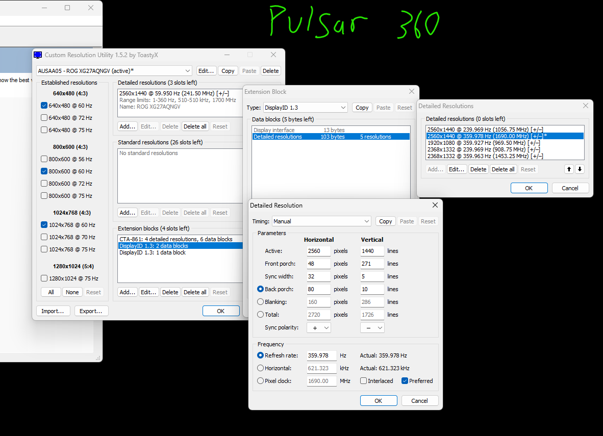

cru values of this xg27aqn vs pg27aqn
pulsar 360.png (119.04 KiB) Viewed 2764 times
