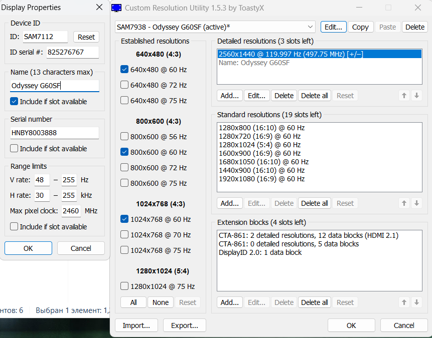

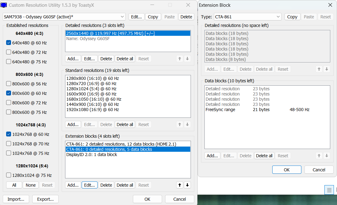

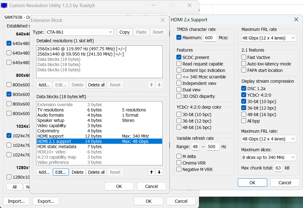

So, I tested various resolutions and frequencies. It turns out, regardless of the resolution, whether 2560x1440 or 1290x720, the monitor refuses to work at anything above 504Hz. At 505Hz, I get a dark screen and the message "Out of range, set optimal 2560x1440@500Hz."
It looks like there's a frequency limit somewhere in the monitor's firmware.
I opened the firmware update .bin file with a HEX editor and didn't find any mention of 504Hz.
Yes, I tried reducing the timings in CRU, but that didn't help.
These were the default settings in CRU. I just added a Display 2.0 block with my custom resolution.
Initially, I didn't even see the 2560x1440@500Hz resolution in these blocks, and I don't understand where the monitor gets it from.

Hi! Tell me, please, what exactly did you do to force the monitor to apply custom settings? I have the same monitor, but it does not respond to changes in the CRU.
windows will ignore EDID changes done through CRU if DSC is active
