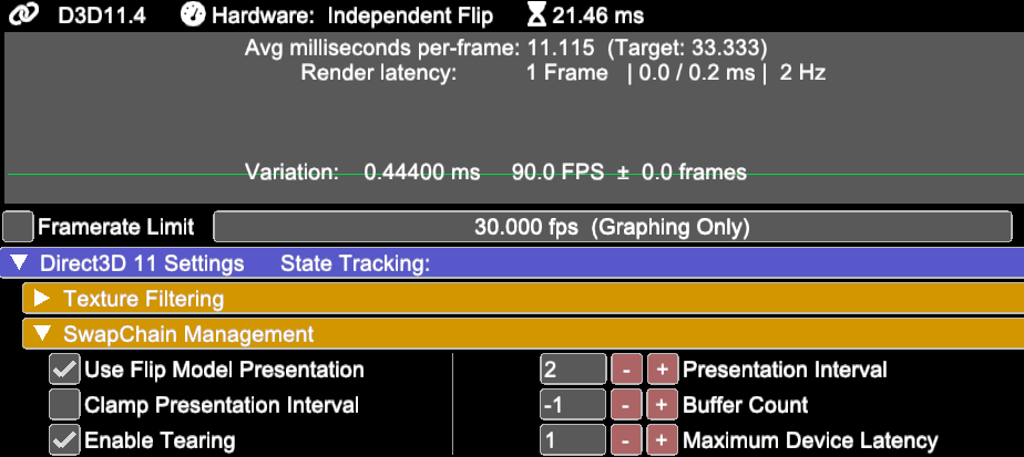

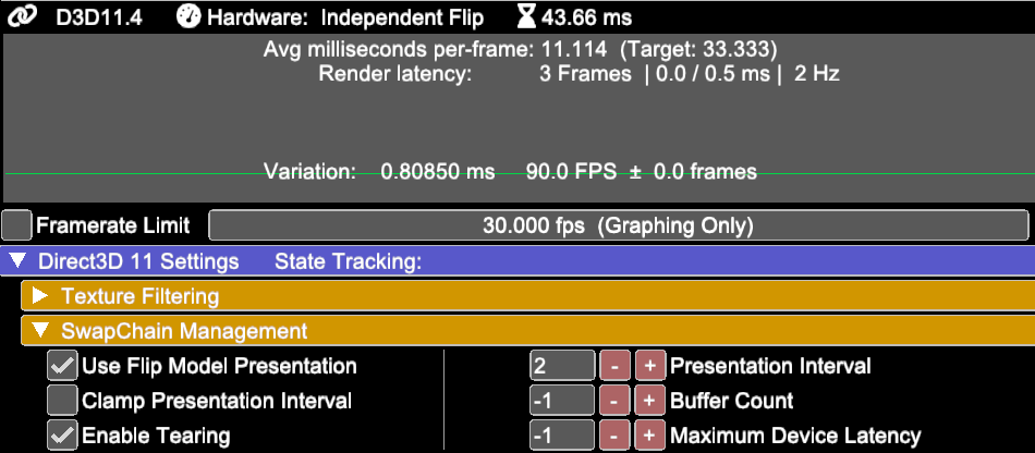

For many DX11 games, you can change this using Special K. Here for example is how this game normally runs:
This is full vsync lag with a render latency of 3. We can change it to a render latency of just 1, and when the game responds well to it (doesn't crash), all the lag is gone and render latency is just 1 frame because now DirectX itself will prevent buffers from filling up:
The swapchain buffer count can also be changed, although if the game responds well to the "max device latency" change, you don't need to and a value of 3 buffers is best to protect against FPS halving when the frame rate falls below the vsync rate.
Unfortunately, this doesn't work for DX12 games as it can't be forced externally there without the game crashing. DX12 games would need to offer this setting themselves (which of course no game does.)
