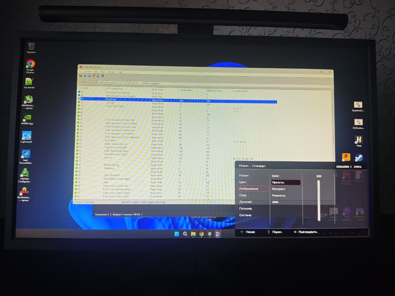

On my monitor XL2546K DI Q250HTN00 A600 (The matrix is from 2022, the monitor itself is from 2023)
Utility - ControlMyMonitor v1.42
I can increase the brightness above the factory setting, but I don’t want to increase it too much. I only reached 200 to take a photo to confirm this. If I constantly use the monitor at this value, it could affect the lifespan of the matrix, right?
- photo_2_2026-07-07_16-15-27.jpg (150.08 KiB) Viewed 660 times
- photo_1_2026-07-07_16-15-27.jpg (108.6 KiB) Viewed 660 times

You can use 255 for no dyac and I think 130 or 135 for dyac with that toolkeybl wrote: ↑07 Jul 2026, 07:20On my monitor XL2546K DI Q250HTN00 A600 (The matrix is from 2022, the monitor itself is from 2023)
It's super bright
keybl
- Posts: 4
- Joined: 18 May 2026, 15:11
Re: XL2546K gets even brighter with strobe utility. normal?
Yes, I did check the maximum possible brightness and it was 255, but there are pressing questions as to why the monitor is so stifled in this parameter.MSIfanboy wrote: ↑11 Jul 2026, 04:55You can use 255 for no dyac and I think 130 or 135 for dyac with that toolkeybl wrote: ↑07 Jul 2026, 07:20On my monitor XL2546K DI Q250HTN00 A600 (The matrix is from 2022, the monitor itself is from 2023)
It's super bright
- IMG_20260712_101858.jpg (5.47 MiB) Viewed 567 times

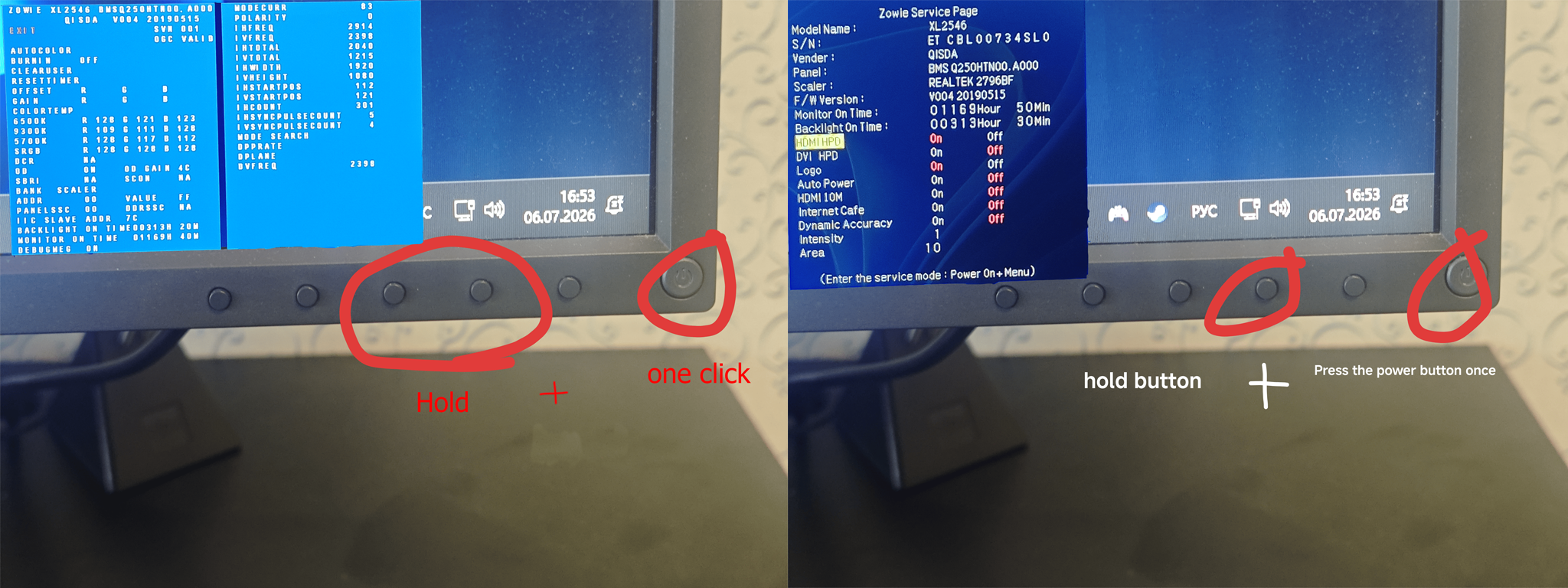

Below I have provided a short guide on how to access ServicePage and ServiceMenu on both monitor models.

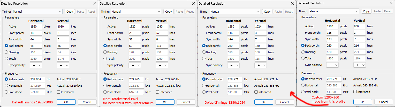

Now some information about DisplayScaling
If I used real resolution scaling on the XL2546, 1280x960 in game - 1280x960 on monitor (CustomResolution by using CRU) in the Nvidia App - Display - no scaling, on monitor Scaling - Full - I got a sharper picture, than scaling 1280x960 to the native resolution of 1920x1080 - gpu scaling / Also, the results for Dyac are better since we have a reserve of total pixels.
On the XL2546K the situation is a little different, when I use real scaling (1280x960 in the game, 1280x960 on the monitor) I get a less clear picture than GPU scaling, I may not have fully grasped this topic, but I noticed that there's a default 1280x1024 profile that overstates the total vertical pixels, not the horizontal ones, as the manual suggests for better results with DYAC. So I simply took that profile, changed it from 1024 to 960, and started testing. I also tested increasing the total vertical pixel count for Dyac at a resolution of 1920x1080 (to have GPU scaling, but the results are better for Dyac), and in fact, so far nothing has come of each result, some better, some worse / I would be grateful if the community could provide any guides on this monitor and how to fine-tune it DYAC.
- Timings(CRU)
- all.png (70.46 KiB) Viewed 563 times
- XL2546K - Factroy+Service
- xl2546k.png (5.77 MiB) Viewed 563 times
- XL2546 - Factroy+Service
- xl2546.png (2.05 MiB) Viewed 563 times
