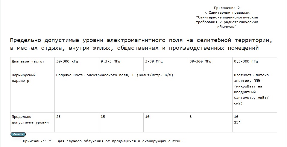

In the next few days, a specialist from my city’s Department of Sanitary and Epidemiological Control will come to my apartment to measure electromagnetic fields across the full frequency range, from 5 Hz up to 300 GHz. I’ll post an update here once I receive the results.
Maximum permissible electromagnetic field levels in residential premises
