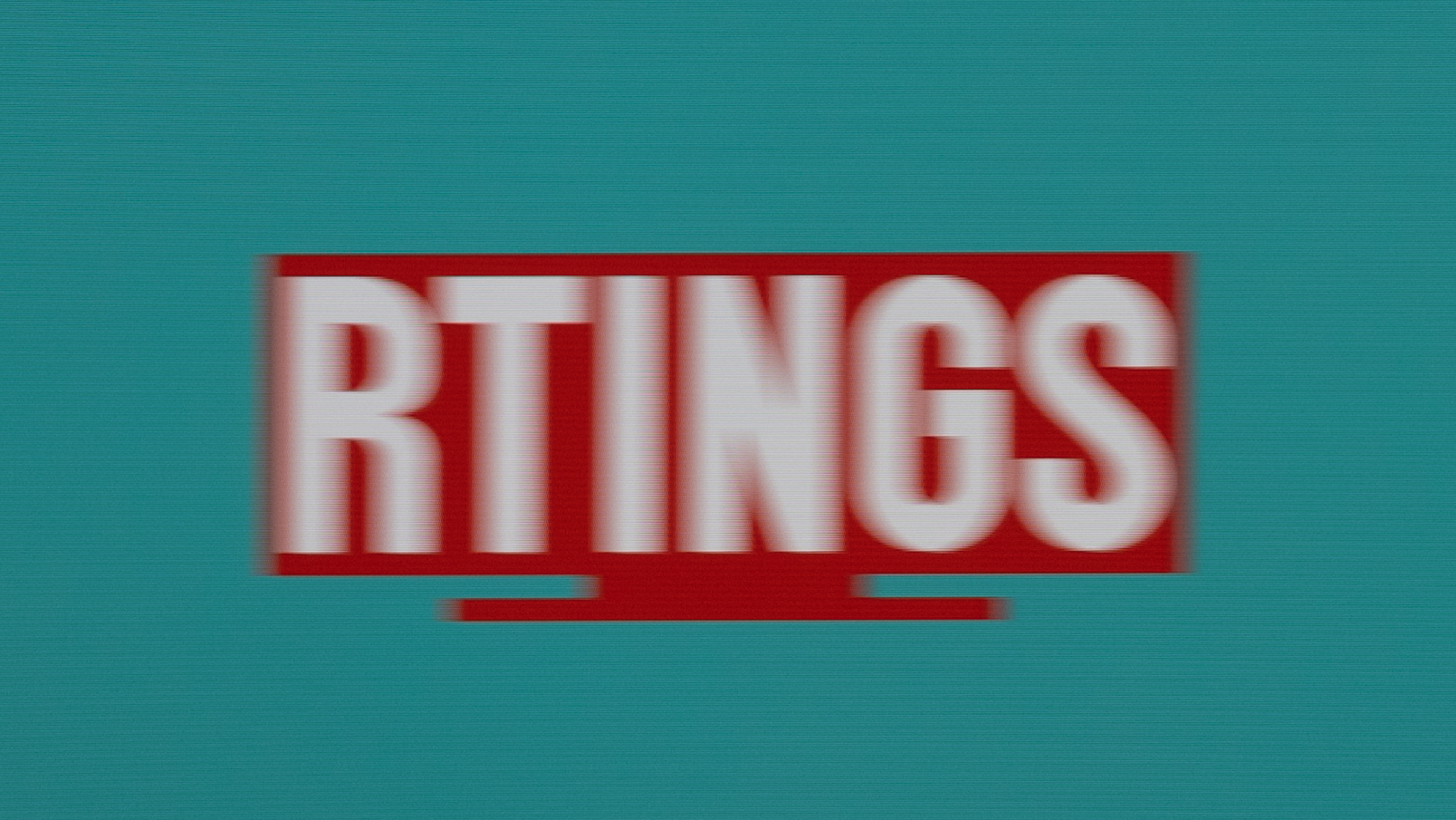

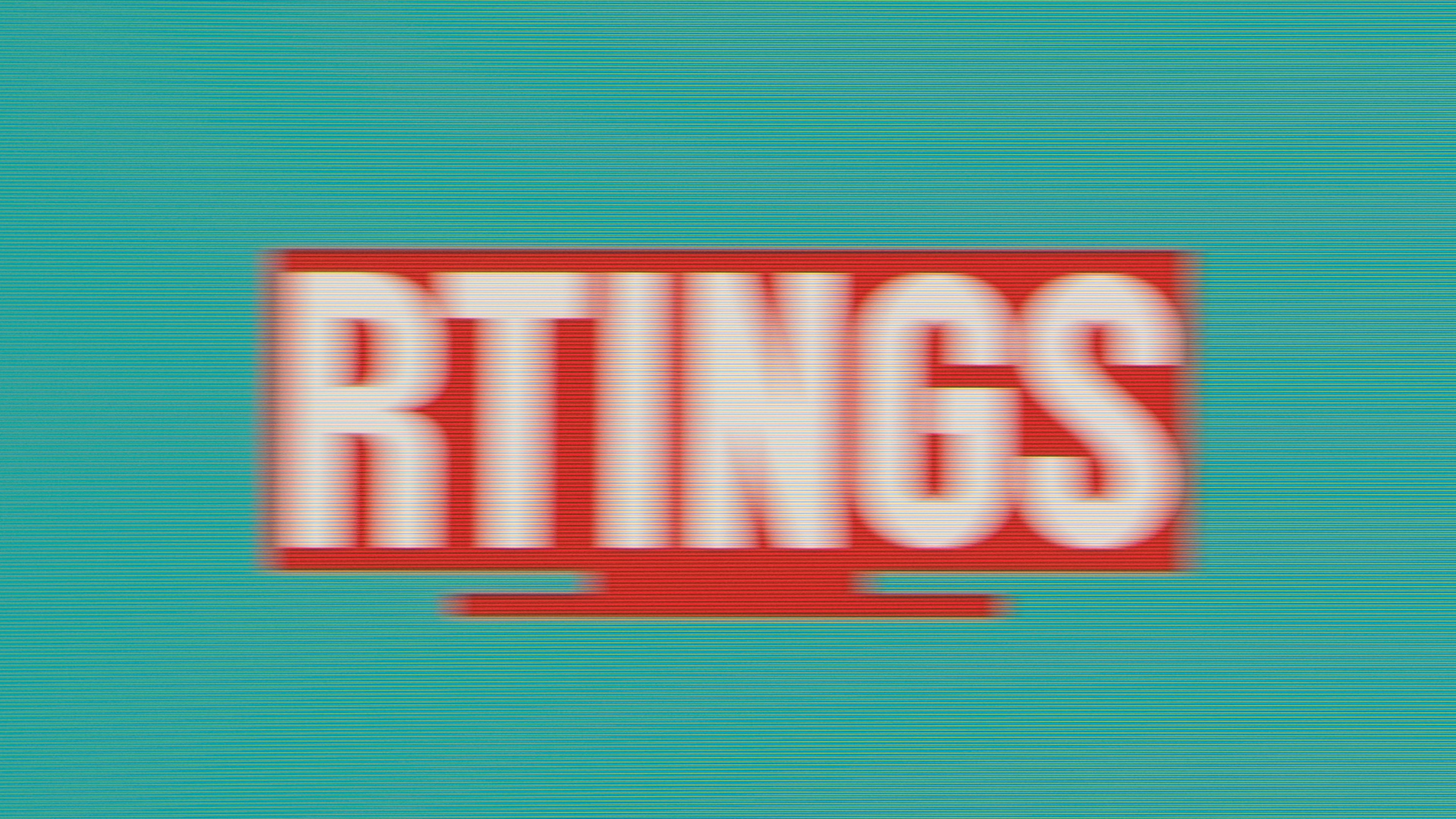

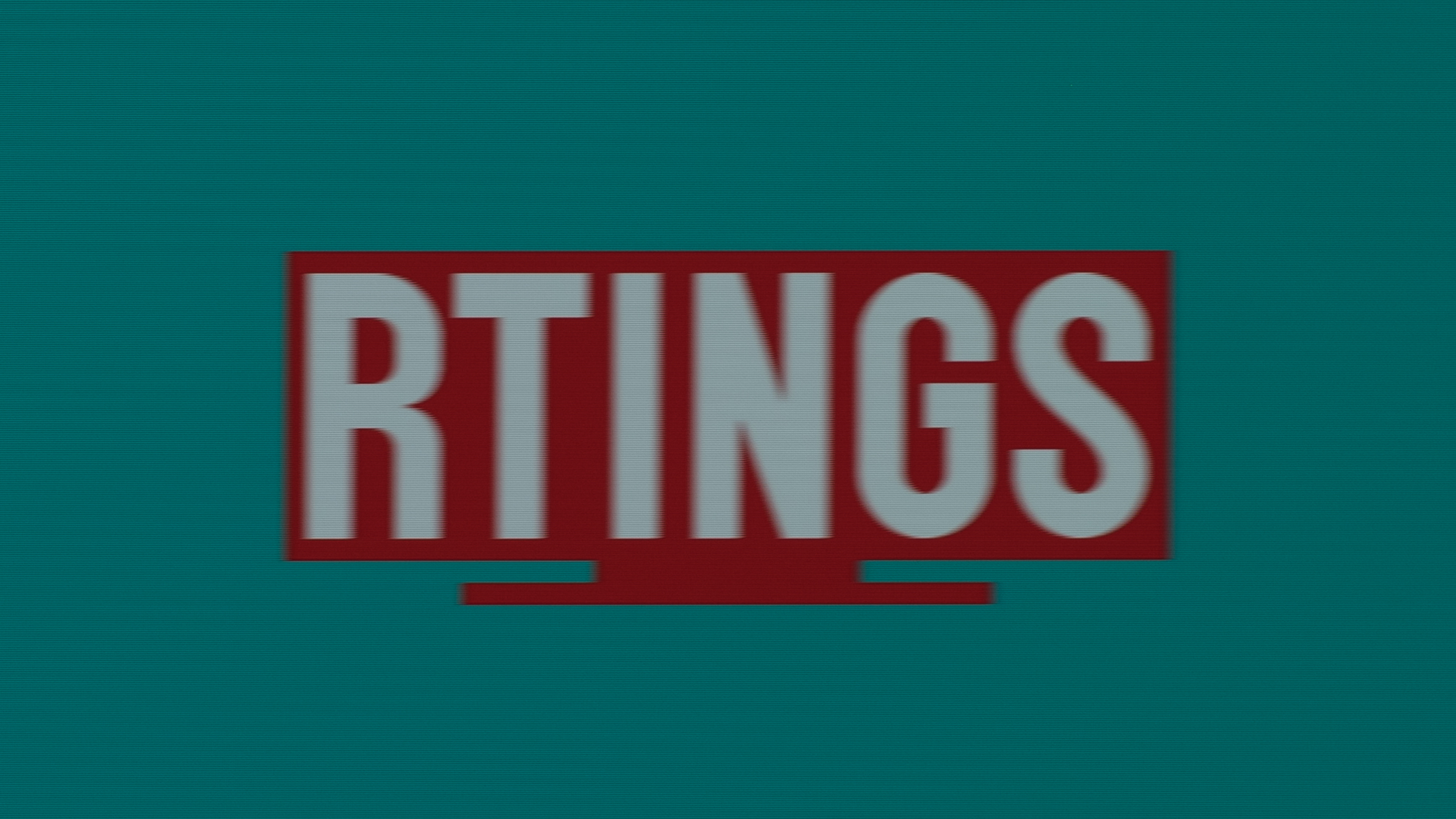

I am not aware of any OLED whose BFI mode goes beyond doubling the motion clarity of a given refresh rate, apart from the LGs from 2019, 2020 and 2021 (perhaps a select few Panasonic models?).Clear Motion Seeker wrote: ↑Yesterday, 15:02Even without a 120hz bfi hardware function, they could integrate a better algorithm similar to what a Sony TV can achieve at 60hz, which emulates some kind of rolling scan effect.
Given the huge amount of brightness in both SDR and HDR with current models, it wouldn't be an issue.
But they don't, because mass market values marketing numbers, fancy design and gimmick functions, much more than actual and pure performance as well as customisation profile that are rather professional oriented.
I don't know for sure and I'd love to be wrong, but can't seem to find anything that supports this on RTINGS.
If we had panels with higher native refresh, it would certainly be possible to do 4 refresh per frames at 60fps on a 240hz panel, I'd take that.
What's infuriating is, we shouldn't have to wait for the next HDMI revision to have higher refresh panels, they could make one solely for the benefit of interpolation and BFI (Takes up to 4K144hz, up-convertible to 4K288hz for example).
Here's a couple of 60hz BFI pursuit shots on various OLEDs, which all look pretty much the same (GX Motion Pro High at the bottom to emphasize the difference in clarity):
- G4.jpg (1.82 MiB) Viewed 36 times
- A95L.jpg (3.31 MiB) Viewed 36 times
- GX.jpg (2.03 MiB) Viewed 36 times
