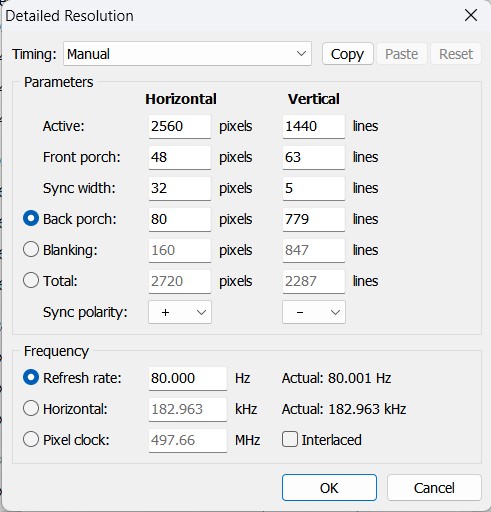

I've had good luck with creating 70/80/90/100 Hz custom qft resolutions based on the 120 Hz mode, with no image retention. The full pulse width range is available, so it behaves like a proper ULMB2 mode.
The only caveat is for whatever reason, the brightness is lower at these custom resolutions compared to the original 120 Hz mode. For example, with max brightness set to 500 and the pulse width set to 40, 120 Hz will be brighter than these derived resolutions. In terms of the difference, the brightness becomes roughly equivalent when the 70/80/90/100 Hz custom resolution modes are set to pulse width of 60 (compared to 40 at 120 Hz).
I'd definitely be curious if others are able to keep the brightness levels the same!
