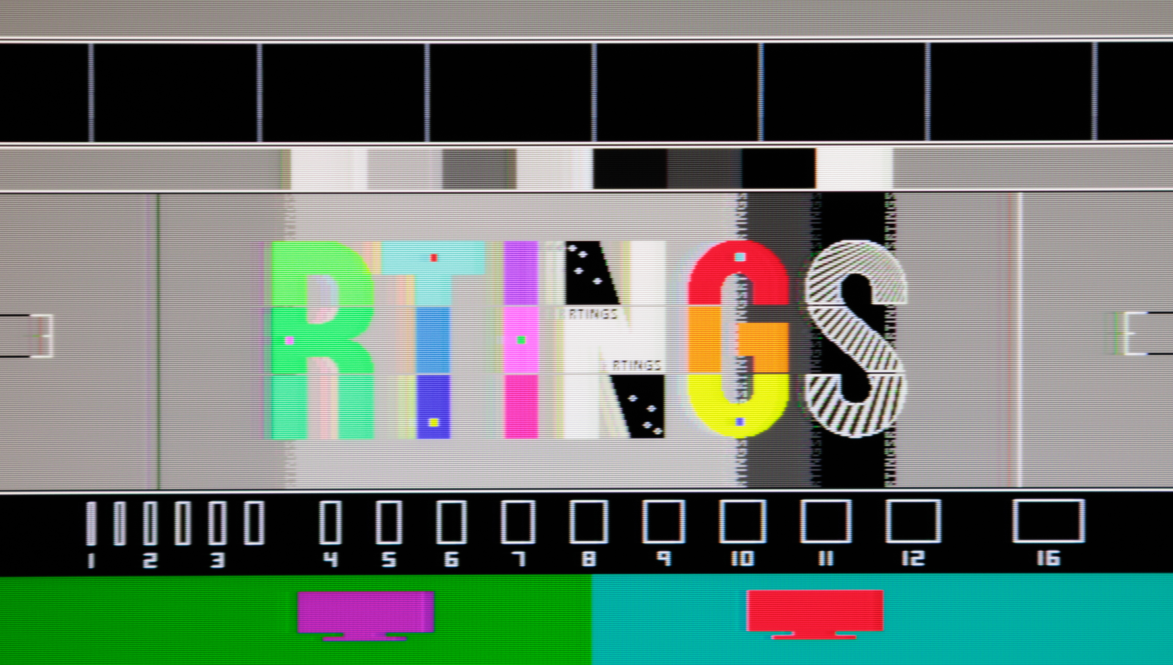

RTINGS seemingly has a review up for the XQ2566X
XQ2566X @ 360Hz @ DyAc3=High
XQ2566X @ 360Hz @ DyAc3=Premium
Here's the XL2566K @ 360Hz @ DyAc+=High, in comparison.
XL2566K @ 360Hz @ DyAc+=Premium
Note: RTINGS uses 1920px/s for their pursuit photographs
Based on Chimolog's XL2566K review, DyAc+=Premium targets a ~16% duty cycle.
This implies a pulse on time of ~0,444 ms
I would argue that this isn't correct, as this would imply the RTINGS photograph to be clearer than it is.
TFTCentral's XL2566K review mentions a 0,625ms pulse on time. This would imply a 22,5% duty cycle, which would make more sense given the slight blurriness of the pursuit photograph of the 66K.
This means that DyAc3's duty cycle lies within the 22,5% & ~30% duty cycle range.
Which means that the pulse on-time is somewhere between 0,7–0,8333 ms (1200-1400Hz effective motion clarity)
Of course, we're at the mercy of RTINGs focus for the pursuit being correct...

I wonder why ghosting/crosstalk is so strong, it's just a 360 Hz TN panel, it should not have any ghosting. Or is it due to backlight bleeding of backlight zones?

Post by betonKruglosuTotchno » 28 Aug 2026, 11:56
Actually, this review shows everything: https://tftcentral.co.uk/articles/nvidi ... -reduction
There's brightness graph which shows very well that there's just too much zoned backlight bleeding which causes some cross-talk.

Post by petight » 29 Aug 2026, 02:49
betonKruglosuTotchno wrote:
28 Aug 2026, 11:56
There is definitely some light bleed between the zones. But I think the ghosting trails are indicative of IPS response times rather than the backlight zone bleed. I have the TN version and it presents with faster transitions and one less trailing image. At max I can make out a second, but on a lot of the stills in the review there are clearly three.
