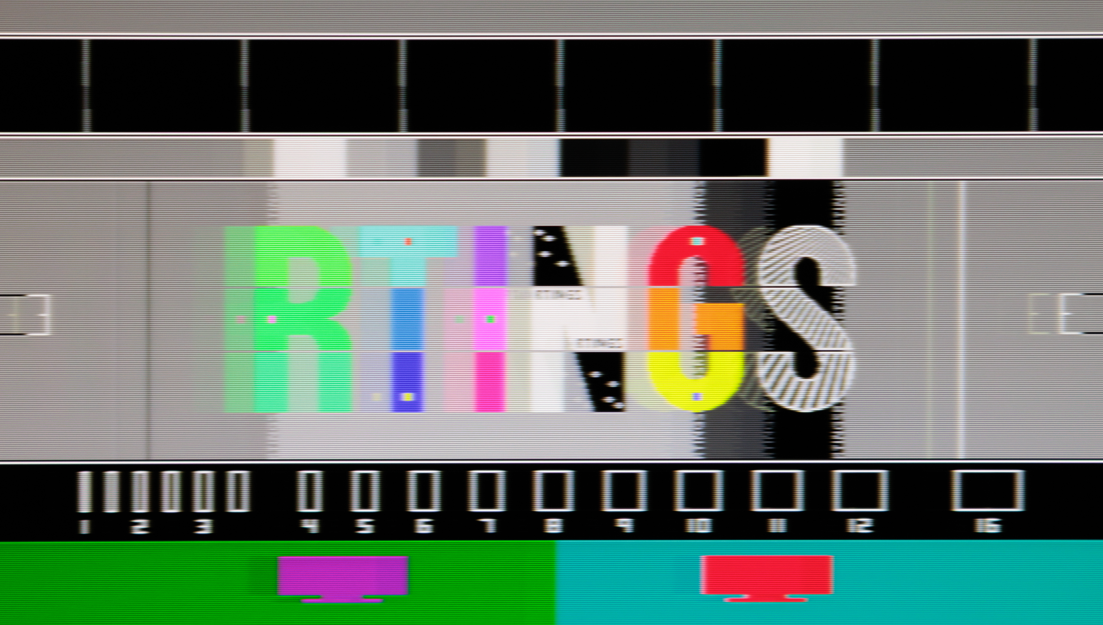

Full RTINGS review is out!
The 120Hz pursuits look horrendous...
Note: All RTINGS pursuit photographs are 1920px/s
DyAc3=Premium @ 120Hz
DyAc3=High @ 120Hz
If only they'd let us adjust pulse width akin to the XL2566K...
This panel's backlight strobing implementation seems to be tuned for native refresh rate operation only.
See here for how it performs on 360Hz
Here's how the XL2566K @ DyAc+=Premium @ 120Hz performed
This is also without the Blurbusters Utilty, which would allow for a even sharper target at the expense of brightness.
Seems that these discrete rolling scan implementations have issues achieving low duty cycles.
