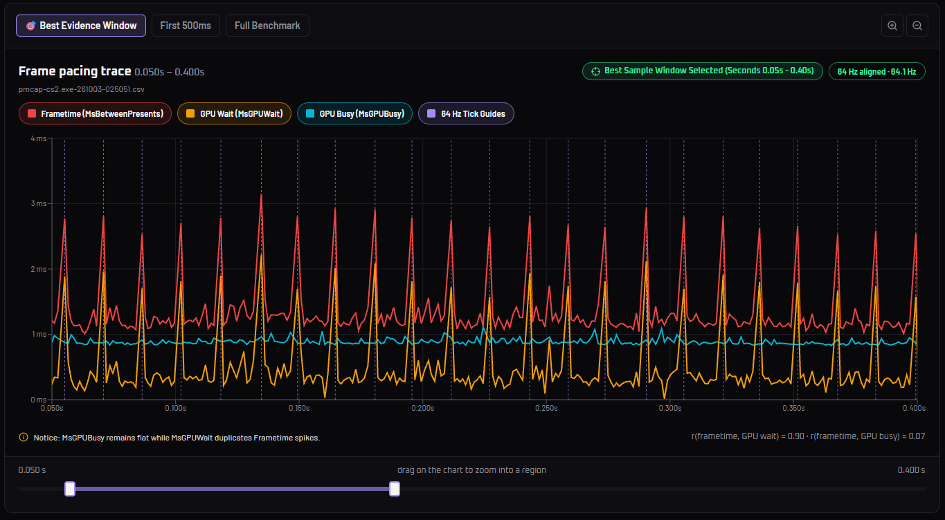

15.625 is exactly windows 11 default timer resolution. Windows 11 has a dynamic timer resolution where each app will wake up to do work at an independent interval. What you might be seeing is background processes waking up every 15.625ms to do work, and that is what's causing that issue.
Enable "GlobalTimerResolutionRequest" in your registry. And see if that interval changes.

Thanks for the input, I've tried with global timer resolution request on and it's even more clear now.soul4kills wrote: ↑Yesterday, 14:4115.625 is exactly windows 11 default timer resolution. Windows 11 has a dynamic timer resolution where each app will wake up to do work at an independent interval. What you might be seeing is background processes waking up every 15.625ms to do work, and that is what's causing that issue.
Btw gpu wait spikes proves that the engine locks render pipeline when processing a tick

Re: CS2 Input Lag Explained - The Monolithic 64 Hz Client Simulation Tick Stalls the Render Thread
Looks like your gpu stabilized. GPU busy is when your gpu is drawing out the scene. Doesn't look as erratic as your previous screenshot. It's also running at under 1ms. Before it was running above 1ms.
