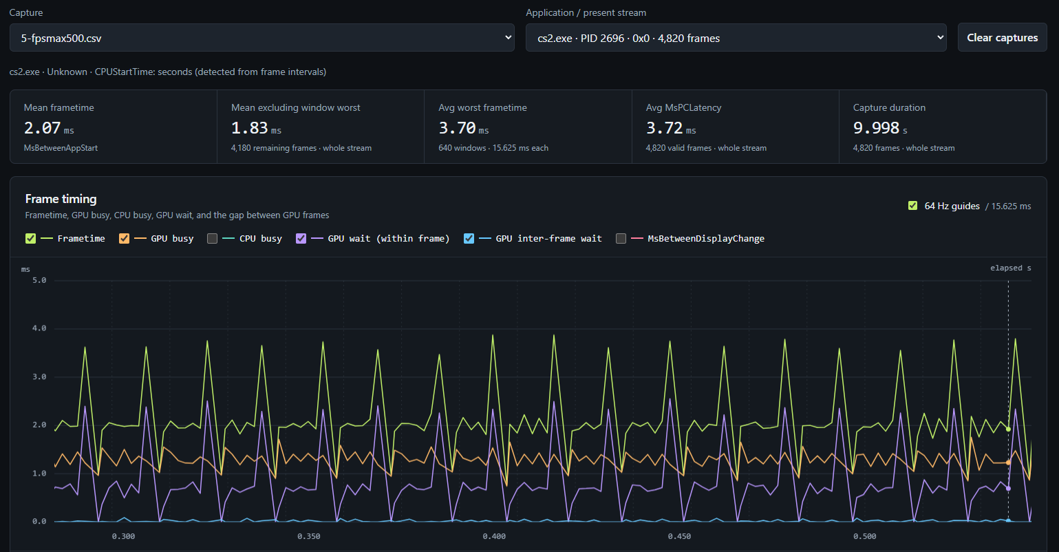

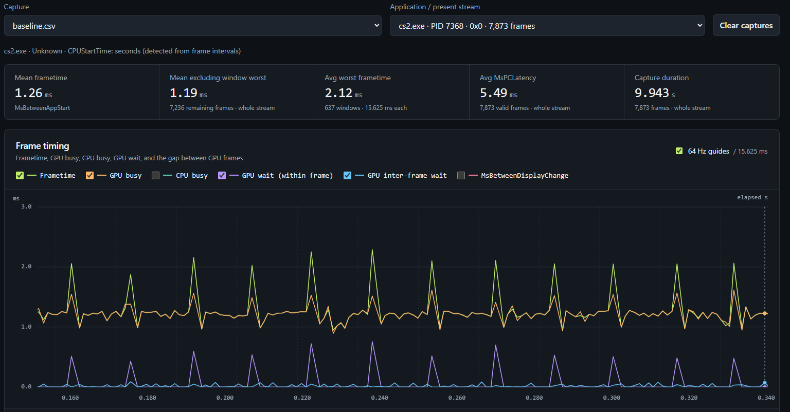

It has nothing to do with scene complexity, the main point of this thread is render pipeline stall due to network tick processing.soul4kills wrote: ↑04 Oct 2026, 18:18It's always good to limit your FPS to reserve some overhead for those peaks and dips on scene complexity. Max FPS isn't always good if you have poor frametime stability. Limiting FPS helps with frametime stability.
I did my own series of testing, fps_max just makes it worse.
Here's my baseline uncapped:
And here's what happens after fps_max 500 is applied:
Uncapped spike is around 2.12ms on average, but if I cap it becomes 3.7ms on average, so limiter just makes it worse.

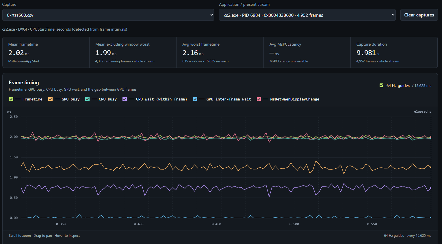

RTSS cap 500 can smooth out 64hz spikes properly, but it adds severe input latency and overall game feel is still unpleasant.
