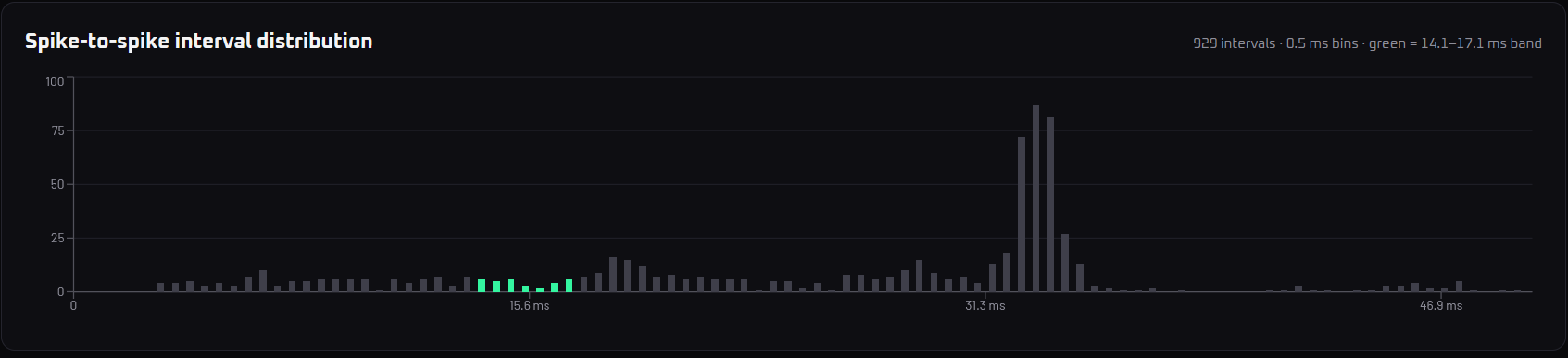

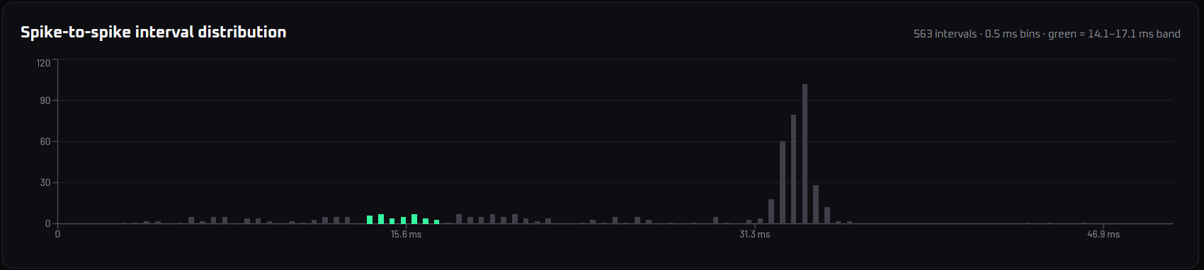

Looks like it's a side affect of gsync+vsync enabled.
edit: added 3 separate readings playing a cs server. focused on the peak to peak distribution reading as that's what matters. I'm not getting that 64hz peak to peak interval that's being discussed.
Screenshot 2026-10-07 000604.png (18.04 KiB) Viewed 117 times
Screenshot 2026-10-07 000616.png (17.66 KiB) Viewed 117 times
Screenshot 2026-10-07 000630.png (17.81 KiB) Viewed 117 times

Post by cuaderno » Today, 06:11
soul4kills wrote: ↑
Today, 01:53
What refresh rate and what cap value did you use?
The spikes show up a lot less on the capture when I cap low, such as fps_max 324 at a 360hz display, even with sync off.
The odd behavior is that despite using fps_max 324, the in-game cap never goes higher than 315 fps. If I used at higher number, like fps_max 360, it would stay steady at 360 fps but the spikes appeared.
