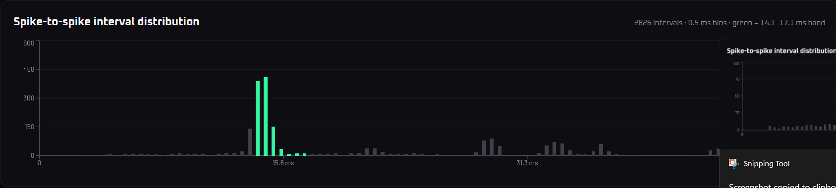

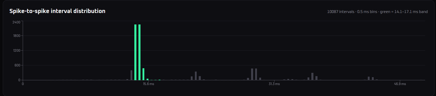

soul4kills
Posts: 106
Joined: 01 Aug 2025, 01:30
Re: CS2 Input Lag Explained - The Monolithic 64 Hz Client Simulation Tick Stalls the Render Thread
Post by soul4kills » Yesterday, 01:53
Looks like it's a side affect of gsync+vsync enabled.
edit: added 3 separate readings playing a cs server. focused on the peak to peak distribution reading as that's what matters. I'm not getting that 64hz peak to peak interval that's being discussed.

soul4kills wrote: ↑
Yesterday, 01:53
What refresh rate and what cap value did you use?
The spikes show up a lot less on the capture when I cap low, such as fps_max 324 at a 360hz display, even with sync off.
The odd behavior is that despite using fps_max 324, the in-game cap never goes higher than 315 fps. If I used at higher number, like fps_max 360, it would stay steady at 360 fps but the spikes appeared.

soul4kills
Posts: 106
Post by soul4kills » Yesterday, 20:21
It did finally rear it's head. But, it's not a very consistent. My frame rate is 138. I have gsync and vsync on with reflex at ultra.
These are all tests on valve servers. I tried it on a custom surf server. It would also be hit or miss of the pattern showing up. The only consistency of the pattern is it stops/appears when the server changes. May not be a valve vs non valve server. Do servers have a syncing routine that happens during connect? Is it possible during connect the server has a bad sync to the client? But even during the times when the pattern did show, I didn't experience any input lag.
Can't you set up your own server and try different configurations and see what setup results in the pattern showing up.
